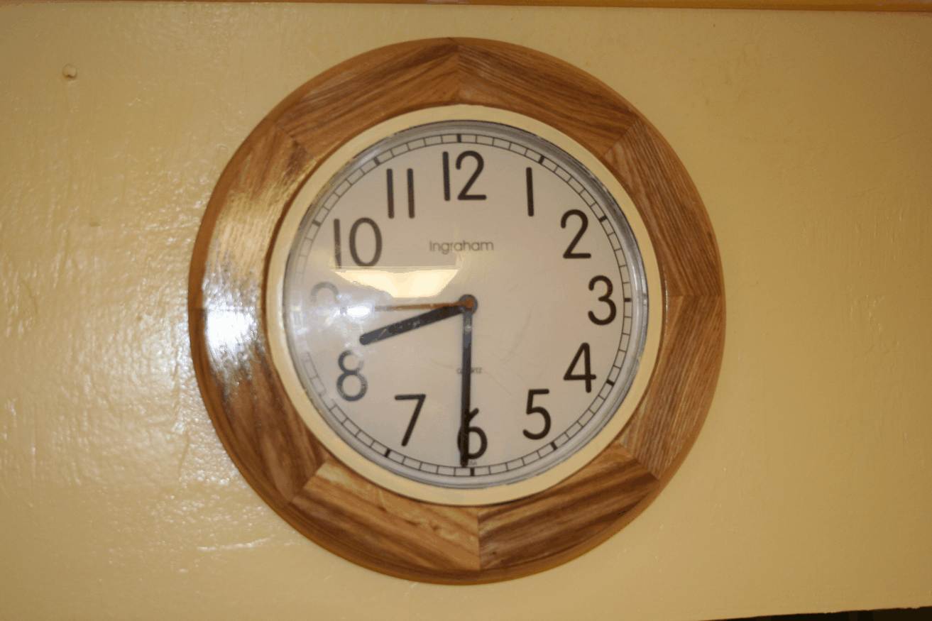

    I just made a frame from the Ash leftovers from my kitchen cabinets, to replace the old not-so-nice-anymore frame. The rim was painted yellow to go with the walls, as LOML refused to see the hunters green again. The edge was routered to the same edge profile as the cabinets.
    The frame came out great. I can appreciate your efforts in the cutting and glue up of all the 22 1/2 degree pieces. I know what a PITA it is to get a good fit, and then clamp up. Yours came out really nice. Got any interim pictures? Or pictures of you pulling your hair out?

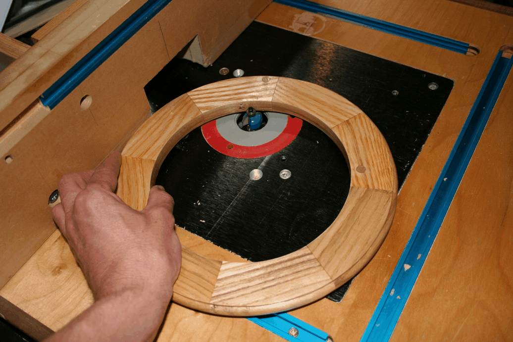

                I clamped the 8 pieces with Rockler's band clamp and some 135 degree "wedges" I rough-cut on a band saw. (I first glued 7 of the 8 pieces, so I could get the rough inner circle cut on the band saw, before gluing up the 8th piece. Then rough cut the outer circle, then used a "table mounted belt sander" as a disc sander to finetune the outer circle and DP mounted sanding drum for the inner circle.

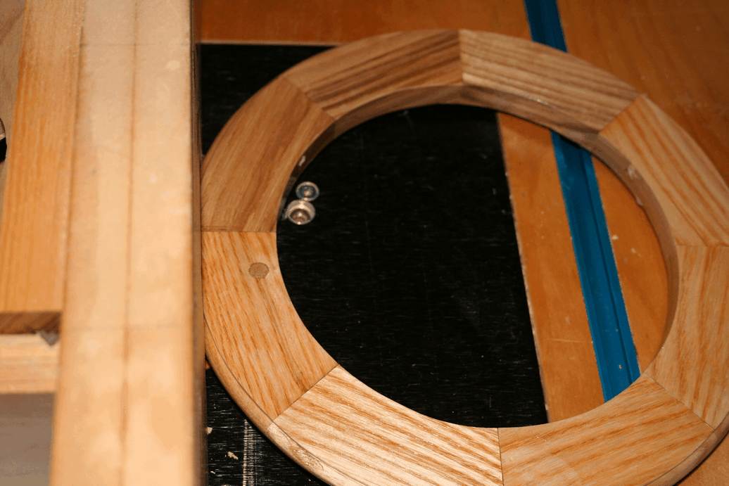

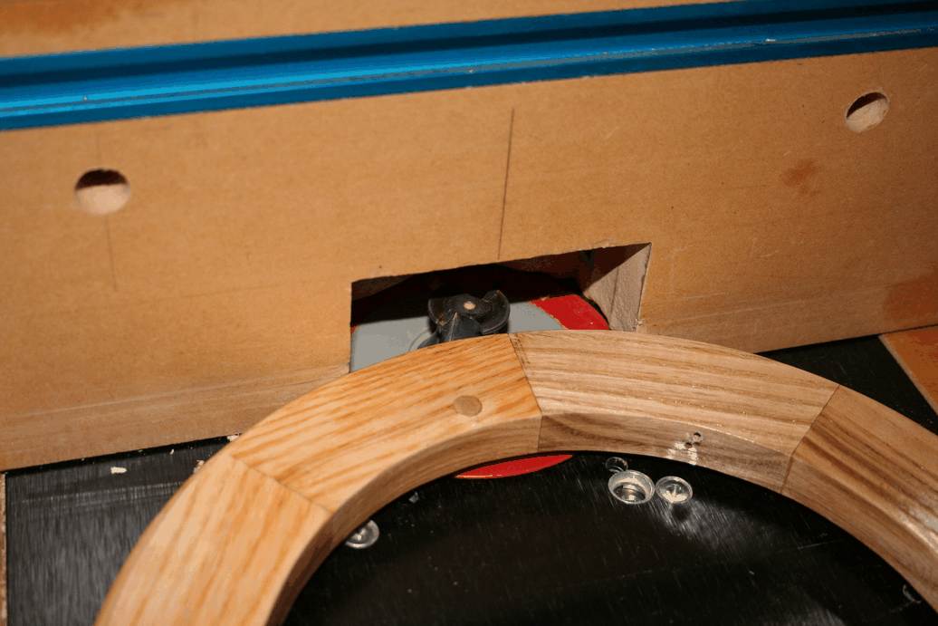

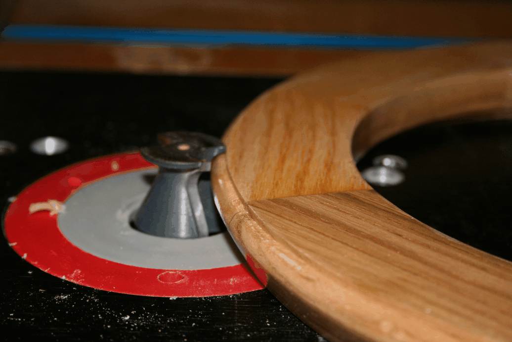

                Then the task that I was nervious about, routing the recess inside for the clock, and the profile outside. I effectively did climb-cuts to prevent tearout, and show the process below. The first pic shows routing the recess in the inner circle, keeping the piece against the fence for support. The next shows the cabinet door profile that I put on the outside, and how I buried the bit in my router fence, about 1/4" (from 1/2" to 1/4" in several passes), and use the large fence opening as guides for the workpiece. Just rotated it through, keeping it firm against both corners in the fence opening.
