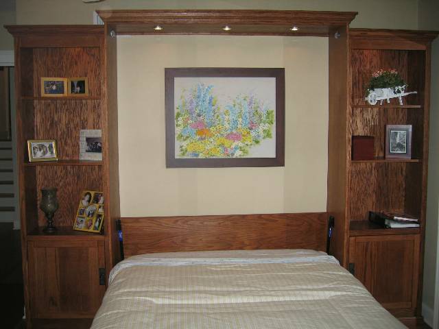

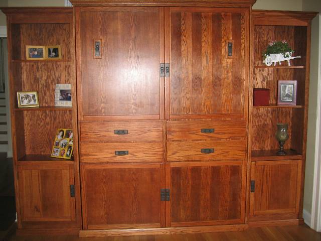

    Hello all, I am a newbie and also a woman woodworker. I have a BT3100 and found your forum looking for some help on the internet. I love the forum and visit almost daily. I have finally finished my Murphy bed project and wanted to share it with all of you. I purchased the Create-a-bed kit from Rockler.

      Welcome aboard. Your Murphy Bed looks terrific. Did you get the Rockler kit with the hydrolic arms? And, how did you get the grain effect on the front?
      More details please.

              Thanks for the post. On my list of projects is a murphy bed for our living room. I also would like more details. Are the doors on the front functional? If so what kind of shelf depth do you have in them?

                  A beautiful job. Nice layout and finish. Is it a full size (double)? Did you add the face pieces to a full sheet for the effect?

                    Thank you all for the praise it means quite a bit to hear from fellow woodworkers. Here is a bit more detail. I purchased the kit "Create-a-bed" from Rockler. The kit comes with all of the hardware you need plus complete plans and cutting list. Best of all there is a DVD that you can watch over and over to help you build it. All you need is plywood and some clear pine to build the whole thing.
                    The wood is simply cabinet grade red oak plywood. I spent a bit of time trying to find some nice panels. Once I found the plywood I went back to rockler to find the stain. I used General Finishes Cherry Dainish oil. I used General finish satin for the clear coat. One coat of Cherry three coats of clear, boy that took awhile. The grain effect is just the grain of the plywood with the cherry stain on it.
                    The "doors" are really just 1/4 red oak molding that I put on the plywood to give the apperance of doors, same with the "drawers" they are 1/4 oak. They are not functional, although my husband asked the same question. The mattress is behind there. I was really trying to give the apperance that there were cabinets and drawers, and I guess it worked. The side bookcases do have actual cabinets though.
                    The bed is a queen size mattress. I already had a queen size bed in this room, I just put the mattress in and it was ready.
