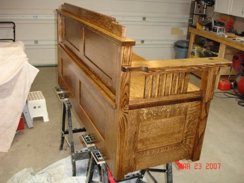

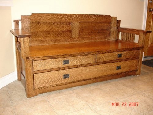

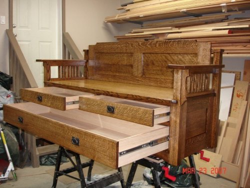

    I just finished this bench, it is my first attempt at furniture. I used quartersawn red oak. I'm quite pleased with the results.

    Good looking piece!
    You should be pleased! That's beautiful work!

      I have a feeling, as G-Mack that whoever you did that for is going to be pleased also. Well done.. well done indeed!

        Very Nice
          That is one sweet looking piece of furniture. Welcome to the forums.

            Only quite pleased? If it was mine I'd be quitt'n the day job and opening a store.

              I guess so!! Great job. Love the cloud lift motif. Love bookmatched panels. Love the piece.
              First furniture project? Yikes, I can't wait to see what's in store!

                Well you may be a "newbie" here, but you ain't one when it comes to woodworking.
                Very, very nifty

                          That is GREAT! How did you do the finish? I love that mission look but have heard that the finish, done with ammonia, is dangerous? Very Nice!!

                            I did the finish with polymerized tung oil (Lee Valley Tools) http://www.leevalley.com. I used a medium luster mixture and applied 7 coats. Rubbed each coat on with fine steel wool, then wiped off with a dry clean cloth after 20 minutes.
