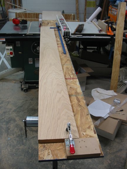

    My lumber suppliers have always had S3S lumber until I moved back to the
    East coast. Now all the lumber I buy is in the rough. No problem since I own
    a planer, but no jointer. So I pick the flattest boards I can find, run them
    through the planer, then I use this jig to cut one straight edge. For about 15
    minutes of work, I am very pleased with the results. It's a scrap of 1/2 OSB
    I ripped to 10" wide. I screwed a hold down toggle at the end of this, then
    screwed a 4' T-track from Rockler onto the side with a screw down clamp. To
    cut a clean edge, I set my fence to 10 1/16", lay my board on top of this jig
    so it overhangs it the whole length, clamp it down, and go. Straight edge
    every time.

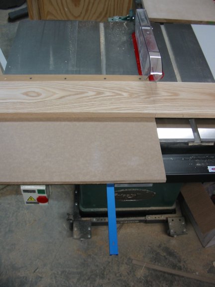

    This other jig is a panel cutting sled. Since I no longer have my BT3100 and the
    sliding table, I had to make this sled for cutting sheet goods or even this long
    board to length. I got the idea to use a section of T-track rather than a strip
    of wood from one of the WWing mags. It's a mini T-track so it's not as tall
    as a normal one, but still 3/4" wide. T-track is screwed to the bottom of
    1/2" MDF that is 16" deep by 30" wide. The fence is a piece of plywood scrap
    screwed to the top and made dead square to the cutoff edge. I cut a 45deg
    microbevel on the bottom front of the "fence" so any stray sawdust goes
    under the fence rather than keeping the board from being square.

    Nice. I too have a planer but no jointer. I may have to give that idea a try. thanks for sharing
    -Paul
      Two great tools, Paul. Nicely done.
        It looks like those will get a lot of use. Nice job.

            My straight-line ripping jig has two movable hold-downs, with holes drilled about 2" OC along its length for adjustment. I like your T-track idea better ... that'd be much quicker and easier to adjust than mine. Well done.
              Those are two very helpful jigs that make the job a little easier.

                Even though I've seen many various types of straight edge ripping jigs, the hold down toggles was clever. On the panel sizer the micro-bevel for saw-dust relief was nothing short of very clever.
                Well done job of thinking it though the process of what you wanted to achieve and well executed after you did!
