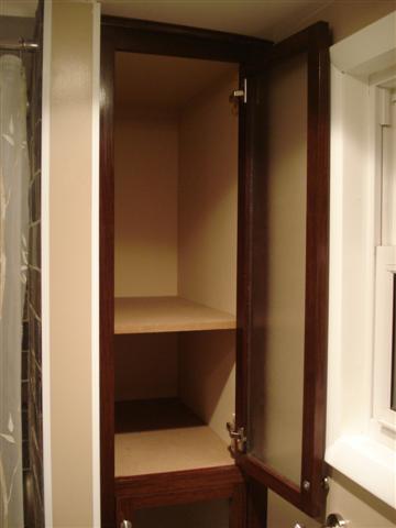

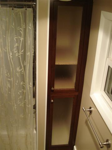

    I eventually came up with a simple solution that would allow me to reuse the plywood carcase (which would have required a major effort to remove from its place) and just give the whole thing a facelift. And here's the almost finished project (urethane coat still needs buffing):
    Either the bathroom is really small or my camera has mediocre zoom or both, because this is the best full-length pic that I can take.
    The top part will store towels and toiletries. The bottom will house the hamper.

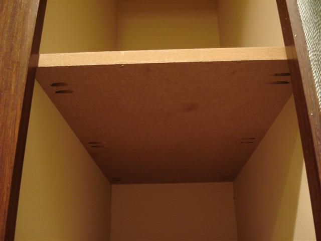

    I started by removing the old face frames, fixed shelves (which were nailed in from the sides), and the cleats that held the removable shelves. Then I lined the entire interior with 3/4" MDF, spackled the screw holes and corners and primed and painted it. I did this for two reasons: (1) The unpainted areas of the old plywood had this really weird smell (like if plywood had body odor, that's probably what it would be like ); (2) I wanted to build up the thickness so I'd have more surface area to glue the new face frame on to.
    I pocket-screwed two fixed shelves into the sides. The pockets will be spackled and the shelves will be painted.

    For the doors, I went for an inset look to match the inset drawers on the vanity. I used M&T's to join the frame members. After all the adjustments, I ended up with a 3/32" gap around the opening, a little over the 1/16" that I was shooting for. After sanding the joints flush, I routed a rabbet around the inside edges of the frame. The glass, which I ordered 1/8" undersized in length and in width, is held in the rabbet by four mitered strips of wood. The glass has a "hammered copper" texture, which LOML really likes (although I think the trade name "Hammered Glass" was a pretty bad marketing decision). It comes in 3/32" thickness.
    I used Blum cup hinges to hang the door. I screwed shims on the carcase side so the carcase part of the hinge would be flush with the face frame opening.
