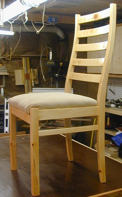

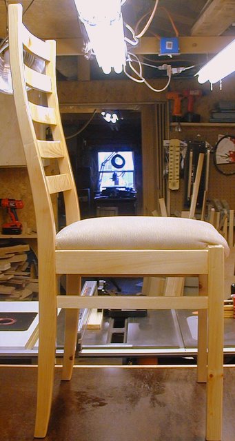

    The Missus placed an order for a dining table and chairs. The table didn't bother me much, but honestly, I've been dreading that first chair for years.
    We found a plan that we both liked and of course it couldn't be a nice simple straight back chair, it had to have curves everywhere!
    I made this prototype out of White Pine, I think the table and chair set will be White Oak, maybe Red Oak. The chair has 22 mortise and tenons, 12 of those are in curved areas.
    The back legs are sawn from 1 3/4 thick by 3 1/2" wide stock, the back slats are sawn from 1 3/4" square stock.
    The prototype is finished with 2 coats of Zinnser Sealcoat followed by 5 coats of wipe-on Ploy.
    I did the seat with material and foam from Walmart.
    Thanks for looking,
    ken

    Very nice for a first, Ken. The curves are very pleasing to the eye and look comfortable, too.
    Are you changing anything from the prototype to the final piece, other than the material?
    I have always considered chairmaking a different discipline from the rest of 'conventional' woodworking, so hats off to you!
    Chris

      That's a pretty nice looking chair.

        That is a beautiful chair. The curves are very nice.
        So what are you gonna do with the prototype when you finish the other chairs?

          First or not, that's a great looking chair Ken!
          For the curvy parts like the long piece on the back legs, do you steam/bend the wood or cut out the curve from a wide piece of wood?

            it doesnt look anything like 'first chair'. i could have sworn that you were an expert! the curve looks great, and most of looks comfortable.
            nice job! any changes you plan on making after you made your 'trial' chair?
            Edit: are the horizontal strips for the back curved aswell?

                              ****, Ken, that is the sweetest 'first' chair I've ever seen...and it's just a prototype! Sweet!
                              In looking at that chair as a larger American (6'+ and 250lbs+) I can see where that chair may hurt me after a nice sit down dinner...where the front legs sit proud of the top of the seat rails. My current dining table chairs have almost the same design where the legs sit slightly higher and even with the seat cushion I get to feeling it after a long sit.
                              This ain't a bashing...that is a fine piece of work!!!
