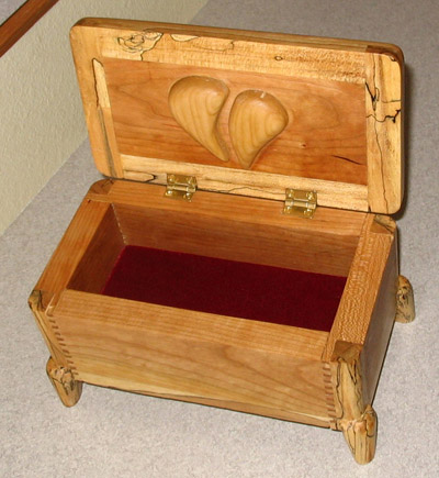

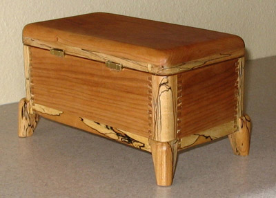

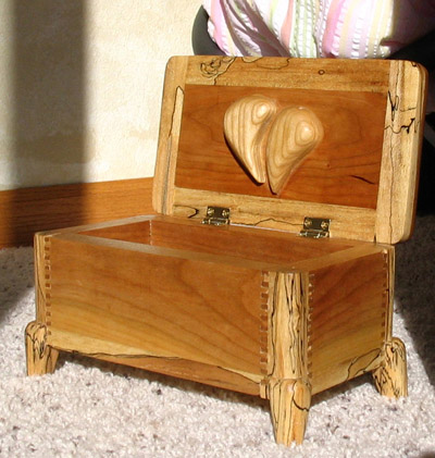

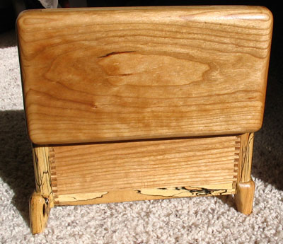

    I made this for LOML's birthday. First "fine" (ie non garage) project. Actually used more or less scrap wood in making this. Made LOTS of mistakes along the way and sort of wish I could have this one back. Fortunately the mistakes essentially aren't obvious to those who dont work with wood.
    I did learn a ton making this and generally enjoyed the process.
    Hinges are Brusso w/95 degree stops, inside bottom is red velvet lined. Heart piece is cherry sapwood (wont darken with age).

    I <heart> the spalted wood. Nice work.

      Beautiful! The way the spalted corner posts are part of the box joints looks great.

          I love the legs. that figure is visually arresting, and you used it well.

                    AWESOME piece of work. The heart on the inside lid is a nice touch.

                      Nice job. Really like the heart.

                        Man, that is beautiful. I love the legs and how they are tied in with the finger joints. And that wood is just amazing - you used it well.

                          I have to admit I'm pretty proud of the DESIGN of this box. I've never seen that technique done anywhere, not sure how I thought of it, but the idea was just there in my head. The biggest thing I'd like to redo on this box is cutting the box/finger joints to accept the corner piece. There was A LOT of tearout on them...

                          The legs turned out to be my fav part too. I got REALLY lucky with making some cuts that accidentally turned out to be exactly the right size. The legs were tricky to work with due to their small size (1 1/4" long and I think 3/4" square) and I rounded all the edges except the inside edge, so they have a sort of teardrop cross section thruout that dosen't really show up in the pics. I also took my time selecting the most highly figured pieces to use for the legs and that really payed off.
                          The hardest, or most labor intensive anyway, part of the project was shaping the cutout on the inside of the legs for the box to sit in. Lots of chisel (I got REALLY lucky and had a rounded corner chisel that was the right size) and sanding work...chisel, check, chisel, check, sand, check, chisel, sand, check...etc.

                          The box is meant to be displayed with the lid open at all times. I gave it to her with the lid closed though, the heart is sort of intended to be the focal point of the piece.
