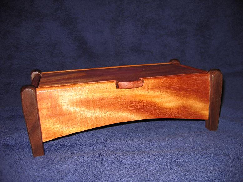

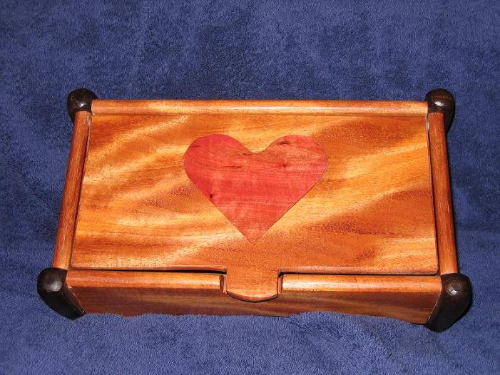

    Here is the latest from the shop. It is a box for a friends daughters B-Day. It is Afirican Mohogany body with a Pink Ivory inlay and Walnut Legs.
    This one has a lot of firsts for me.
    1. Hand shaping and rounding
    2. Biscut Joinery
    3. Tapers
    4. Inlay
    5. Prefinishing
    6. Pin Hinges
    Thanks for Looking...

    Very nice!
    • SHADOWFOX
      • 1232
      • IL, USA.
      • DELTA 36-675
      Excellent looking piece, Otter! Great job!
      Chris
        • 10453
        Great job, Otter! The lines have a nice flow to them!

          You are headed in the right direction ~ a nice looking box.

            Nice job!!!!
            -- Johnny Carson
              Nice Otter. I like the way the top fits and the curves on the bottom.

                wow! a really sexy little box, and a very rich gift.
                can you give some details on how you finished it, specially the mahogany?
                - Aristotle
                  Very nice work and it is beautiful.
                    • 5633
                    Sweet! It looks like it has a nice soft feel to it.

                      Very nice glow and flow on that box! Nice work, Otter!
                        Sure thing....
                        First the stuff dose not like to hold a edge. It is a fuzzy wood, even given its figure. So most of the battle was taming the fur. After rasing the grain several times I used Enduro grain filler then sanded with a 400 grit and then sprayed with Compliant Enduro poly.

                          Excellent job. Great inlay work.

                            Nice looking box. I want to learn how to do inlays...perhaps a box is the way to start.
                            RS
                              Very nice.
