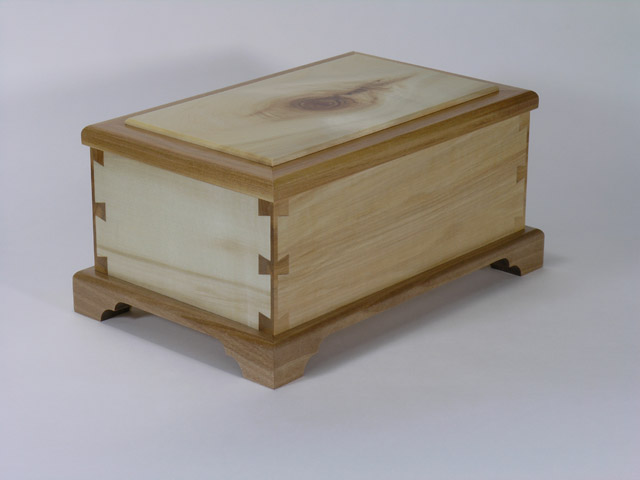

    Birch and Poplar were used here but next time I plan to use wood with more contrast, but this was a test piece so all the wood came from the scrap bin … I was starting to feel guilty about the size of some of the contents in my scrap bin.
    Eight coats of wipe on poly.

    Very nice piece

      That is really pretty nice. Have any tips, etc., that you learned from making it?

        I dig the way you featured the knot. Very cool.

          I'm curious about how you did the corners. It looks like you dovetailed both the side and ends into a corner block. Am I seeing this correctly?

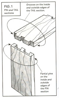

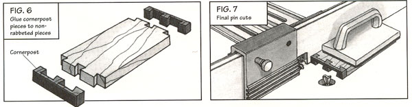

              You are correct and here are the instructions from the manual

                That's a great looking box, well done. I love the figure of the top, showcasing the knot.

                    It looks a lot cooler than I would have thought. The contrast is subtle, but noticeable.
                    Nice box.

                        That is very nice. Beautiful work.
                          Beautiful box, Brian. The combination of the knot and the curly figure in the top is outstanding!
                            Very nice.
                              I like the amount of contrast, pleasing, but not overpowering. You have a winner there.
