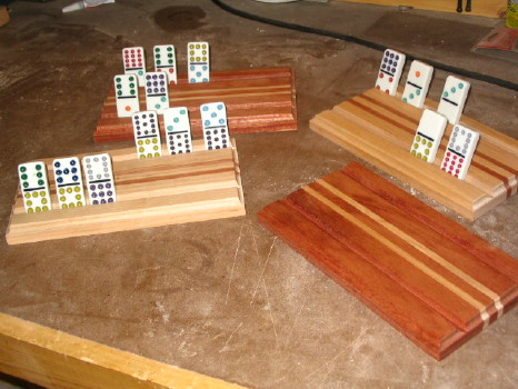

    Small simple project for my Grandmother and her girlfriends who recently started playing Dominos together. These are Maple and Mahogony with a Danish Oil finish.
    As suspected routing the profile burnt like crazy on the maple end grain on a test piece. A few searches at trusty BTCentral and a few changes and I didn't get one burn mark on any of the pieces.
                  Nice job Eric! What were the changes that you implemented?

                    Thanks for the comments guys.
                    I didn't but any baise, etc on the wood. They are left natural with WATCO Danish oil.
                    Larry, Funny thing is my dad saw an add for these. Made of plastic off-white. Very ugly. $7.50 plus shipping. I made these with Mahogny and Maple 1x8x2' (finished size is 9x4 3/4). and have $20.00 into them. Cheaper then the plastic set. I used a wider board to allow the grain to match up through the strips. Another idea I thought of after the fact is to use a wider board and run the grain in the opposite direction to put the wood strips verticle. Then with a plug cutter you can make the boards look like dominos (just don't put any where the groove would be).
                    They are from a double 12 set. We play alot of Mexican War Train, Grandma likes Chickenfoot, which is similiar.
                    One thing I noticed is that not all the tiles are ground to an identical thickness. There are about 6 pieces in my 91 piece set that are snug.
                    The longest part of the project was getting the groove at the right thickness, depth, and angle (20degrees)
                    Routing changes. First I used the hand held router is figured on it burning. Then I dropped the router in the table and used the fence with the roman ogee aligned ont he bearing. Reduced the cut depth. Increased the feed rate (much faster then I usually run). I was going to use the entire bit, but on the real peices after the first pass at 1/8" I liked the looked and stopped there.
