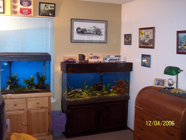

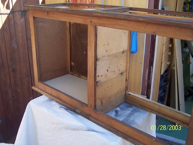

    Aquarium Stand and Hood

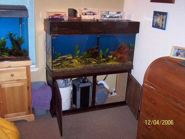

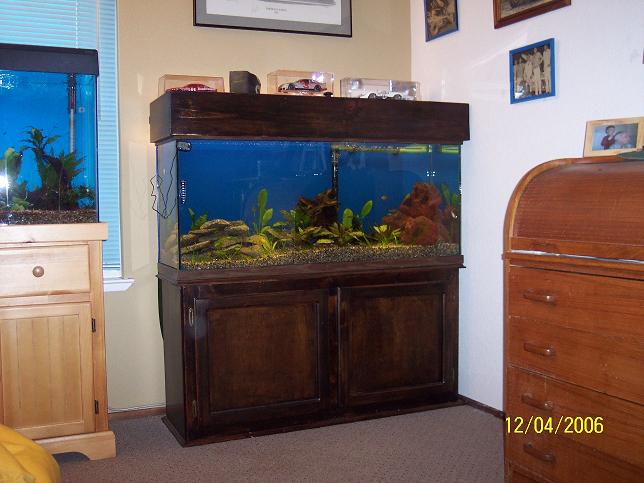

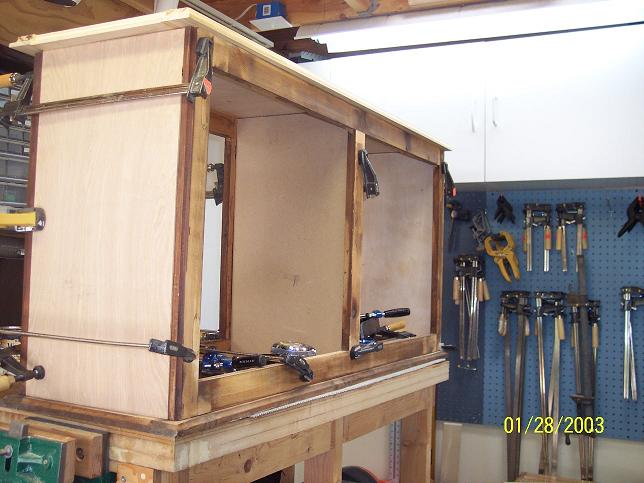

    Back in September I purchased a 55 gal. aquarium and stand on Ebay for $33. This is an older set and the Aquarium weighs over 150 lb. (3/8+ thick glass) the stand which I think was homemade, consisted of 4 face frames with 2 ends and a center partition of particle board. No floor or top, just the face frames. In October I decided to set it up and see how cheap I could do it. The aquarium need a good cleaning and a filter and lights. The stand was a mess warped face frames, loose joints (single pocket hole joints) The wood looked like Pine or Doug Fir. full of knots and dings of various shapes and sizes which I reused other than the top. Since I was doing this on the cheap I used whatever wood I had laying around. I built a new top added a floor and new end and center panels, then stained it with dark walnut to even out the color. and finished it with 4 coats of satin water based poly. The hood was made of scrap pine 1 x 8 ripped down painted gloss white inside for reflection of light. The light fixtures is a left over shop light that was never installed in the shop or garage. I did purchase a new canister filter ($34 on Ebay) two flourescent tubes at HD total cost $85 set up and running. Pictures 1 & 2 are of the stand as I received it #3 is the new top being glued up Plywood and pine face frame using biscuts #4 new floor 3/4 MDF and warped face frame #5 dry fit end panels were attached to front and rear face frame using glue and biscuts, #6 is refinished doors, 7,8,9 finished tank all set up with fish. I also made cleats that attached to centr and end panel to fasten top to. Very sturdy and heavier stand now. Fun project, got rid of a lot of scrap and finish material. Still need to make shelf for right side of cabinet. Now that I have figured out how to resize and post picture I will show more of my projects. There is a glass cover over tank so there is not moisture problem for the lights.

    Wow! Looks very great!
    Ric
      Very very nice work, especially for using cutoffs. I see you have another aquarium there. Salt or fresh water?
      My brother has a salt water. He had a 55gal until my SIL botched a refinish job last week 3 days before they were supposed to have a dinner party. He said the house smelled like the stain and it looked terrible. He went to buy a stand and discovered for not much more he could get a a 90gal+stand. He was planning on making a stand eventually but now says no. He doesn't want to move that 90gal aquarium.

              Nice job - thanks for posting before and after pictures!

                    The original stand only looks homemade. In fact, some place cranks them out for both 55 gallon and 125 gallon sizes. My daughter got one of the larger ones. We, too, ended up refinishing it, adding floors, building a hood, etc. Decided to paint it a color that matched others in our living room, as the wood was as mediocre as yours. The most interesting part of the process was designing and setting up the lighting. We used 8 32W T8 bulbs, 4 on each of 2 ballasts, the 2 pairs of 4 bulbs each starting from one end of the 6' hood and interlacing in the central 4' about 1.5" apart. Gives a very bright light!
                    - David
                      That came out beautiful, Tom!
                        Very nice.
                          Great work. It looks very nice.
                            Excellent re-do. You would never guess what it looked like to start with.
