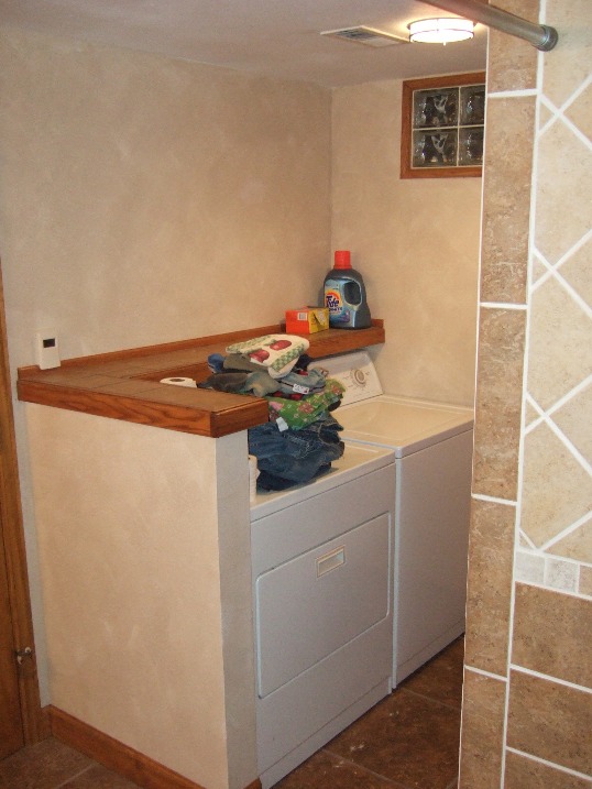

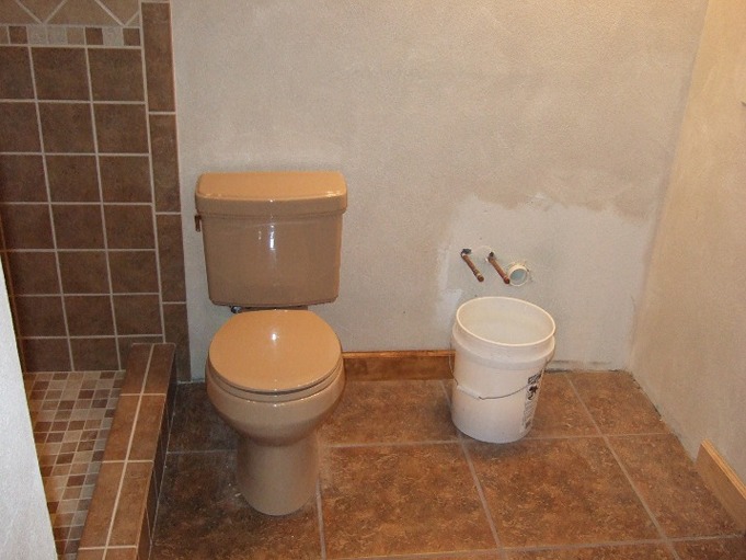

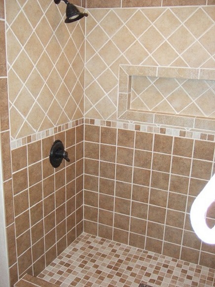

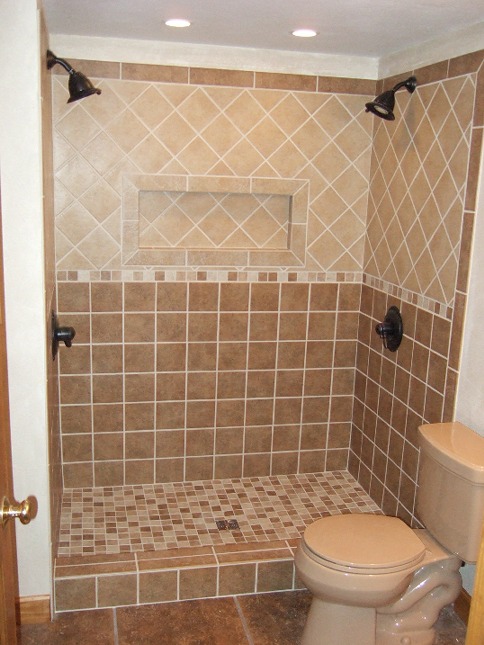

    I have been toiling away on this bathroom all year and I'm finally down to cabinetry.
    The bathroom originaly was right smack dab in the middle of my basement. I tore it out planning to put it in a different location. Years later I finally got around to putting it back in. I had to cut channels in the basement slab for about 20' to hit the sewer line and then rough in the plumbing for the bathroom and repour the flour.
    The tile floor is heated by a cable heat system embedded in the tile mortor. The shower is American Olean Vilano tile with Kerdi waterproof membrane system behind.

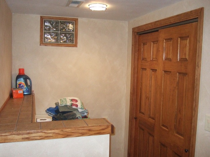

    I almost have my woodworking tools together to tackle the 36" vanity and 54" of wall cabinets over the washer/dryer.

    That's sweet, love the tile work. The double shower head is pretty cool too.

      Thanks!
      If anyone ever pays me to do a bathroom for them..... diagonal tile is extra! Wow what alot of extra work that was. Took four times as long to do as the lower half.
      I am putting in clear frameless glass doors for the shower.

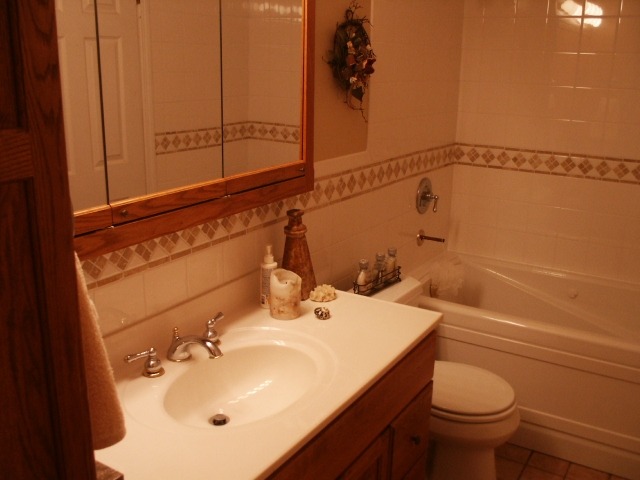

      This is only my 2nd bathroom attempt. I did the primary bathroom upstairs first. That was a little simpler. I didn't have to bust up foundation or anything but still pretty intimidating for my first attempt. The subfloor was rotten from the previous owner letting water sit on the awesome vinyl floor.
      The 60" long whirlpool tub was a real chore to get into position in a room that was only 59" wide. The tub surround is on durok cement board over a vapor barrier.
      The cabinetry is from birch bath and I remember how much it cost... which is why I'm in this forum now learning how to make my own darn cabinets from rough cut lumber

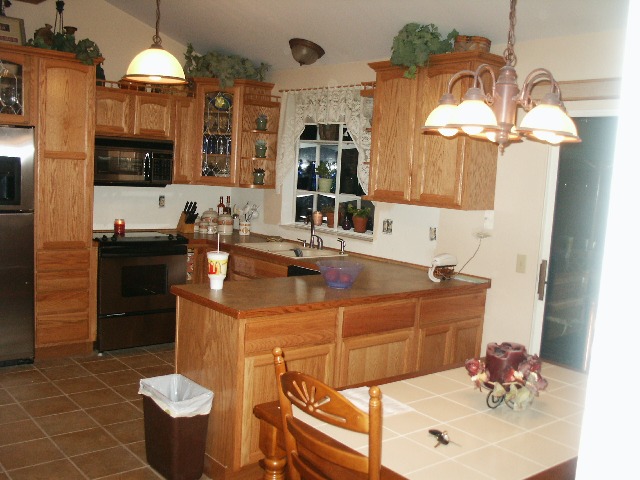

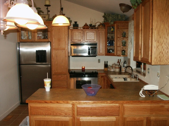

                        Kitchen - I put down the tile floor and overpaid for cabinets. I was still new to the game and the cabinets were expensive so the wife didn't want me installing them so I paid for installation. I watched the two guys install the cabinets and I felt like an idiot.
                        I see the folly of my ways and now realize I could have bought all my tools (that I just got to do my bathroom cabinets) and wood and saved about $5000 off the price of those cabinets and install easily

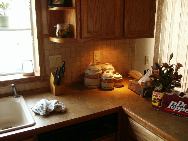

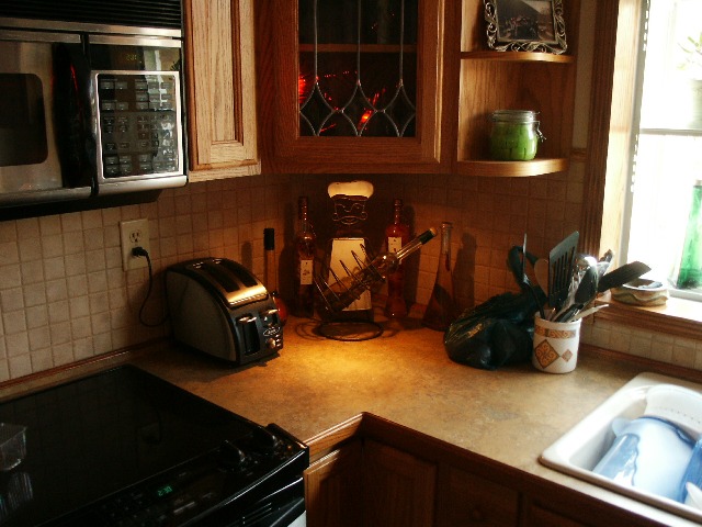

                        After the cabinets were in I reframed the window. It was actually 1 1/4" off level. I never noticed it before because my old cabinets were a little lower and the backsplash tile was fudged to cover it up. As soon as that new counter top went in it was obvious. I had to pull my ceder siding off the outside of the house, pull the window, reshim it, put the siding back on and I cased the inside of the window in oak instead of drywall.
                        I also installed under cabinet lighting and the backsplash after the cabinets went in.

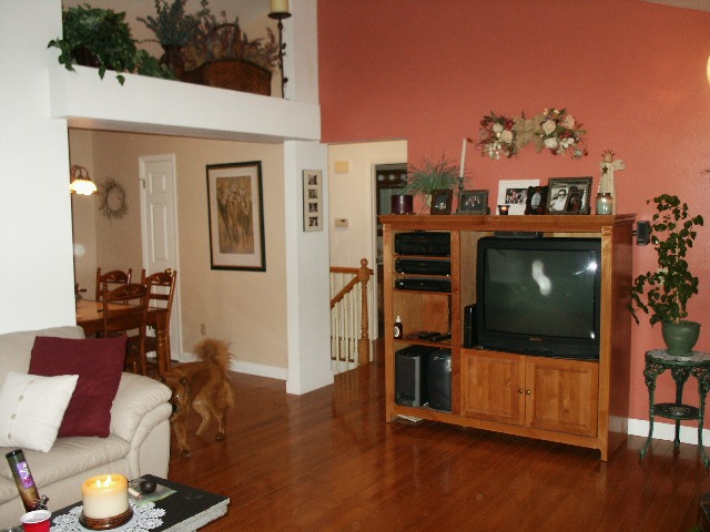

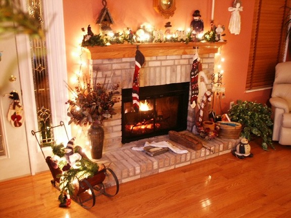

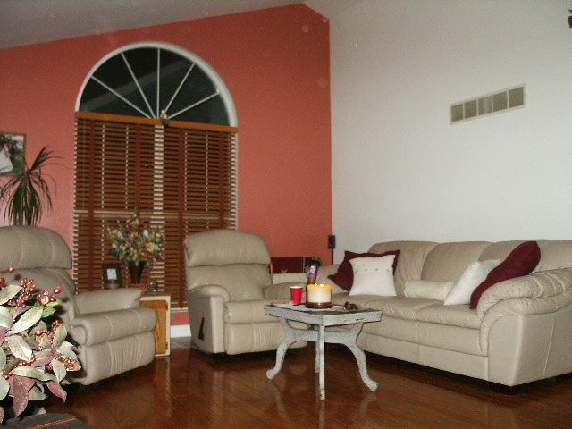

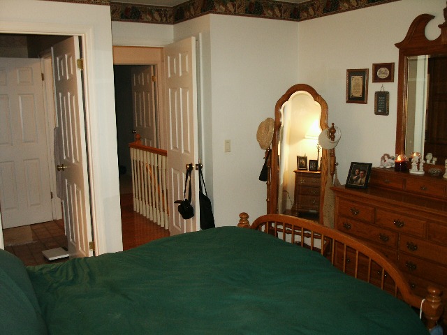

                          Then I installed hardwood in the rest of the house, ripped off the crappy tile face on my fireplace and put a brick hearth in it's place and replaced the hideous builder quality steel front door.

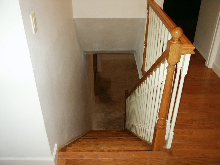

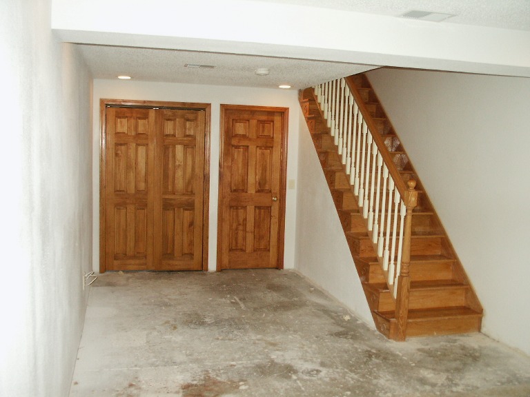

                            The staircase downstairs was carpeted and enclosed in drywall with a 90 turn through a open doorway into a hallway at the bottom. I ripped out the walls surrounding the staircase and replaced it with oak.

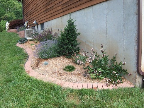

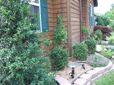

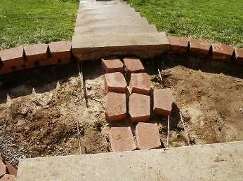

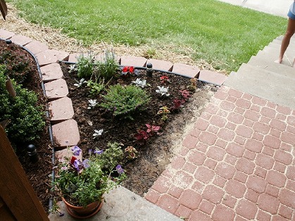

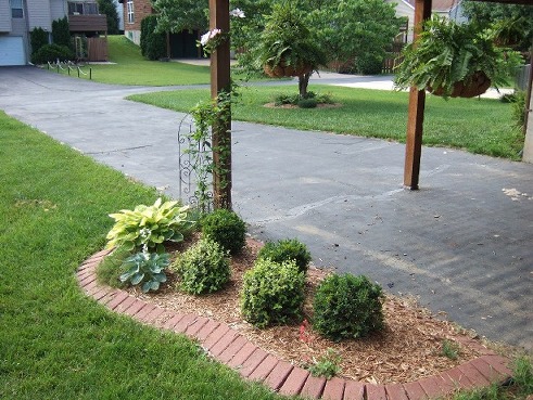

                              and of course landscaping. I had a cracked slab at the top of my steps so I busted it out and repoured it 3 inches lower then the top step and used pavers on top.
