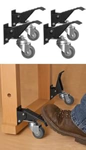

              Right now, my plan is to make my bench mobile.
              I am going to possibly try upside down french cleats (so they are removable) attached to these.
