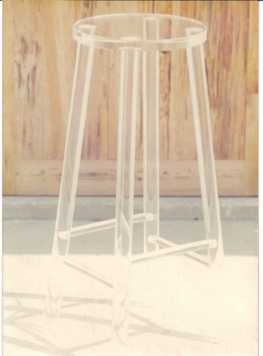

    I've made a variety of Plexiglas/Lucite items, but this one was a thriller to figure out the angles and mortising the members for a clean clear joint. Not much room for error. I don't know how the picture will show, as the subject is see through. Thought I would post it for an example of something not to try if you get angry and throw things around the shop.

    Very, very impressive, but if you don't mind...WHY? Was this for a client, or just to see if you could do it?
      It was for a client, had to make four. It was one of those questions that came up when rent was coming due "Can you make plexiglas bar stools?" My answer was, "I can do that." Once again, I got lucky.

        While I'm very impressed with your workmanship, I have to question the safety aspects. Given that this is a barstool, one would assume it might be used in a dimly lit room frequented by folks who've had a few...gotta wonder if transparent furniture is the best idea...."

            I can't think of any other material that would show true crafstmanship, or lack thereof more clearly.
            I don't think we'll being seeing "Made in China" on massed produced plexiglass product anytime soon.

              How did you get the holes to come out so nice and clear? Any time I have cut plexi or other plastics, the cut edge is looks like frosted glass.

                looks nice. And 25, I belive you want to use a blowtorch on it.

                  I have found that for looks, you can't beat acrylics. I find polycarbonate easier to work, but it's not quite as crystal clear as acrylics can be.
                  I know polycarbonate has moisture inside it and if you want to thermoform or even get a perfect glue joint without haze or bubbles, you have to remove the moisture. That process takes about a day in an oven at specific temps and has to be worked immediately after. Far too involved for what I do.
                  Acrylics also lend themselves better to flame polishing for this very reason. Try to flame polish polycarbonate that still has lots of moisture and you will get lots of tiny bubbles. Okay in champaign, not so desireable in a plastic product.

                      BTW, any idea what load that stool could hold???
                        Thanks for the compliments. Without getting technical, they were as sturdy as a wood stool, but slightly heavier. Polishing can be done with a torch. Sanding and rubbing out works better for some areas than a torch.
