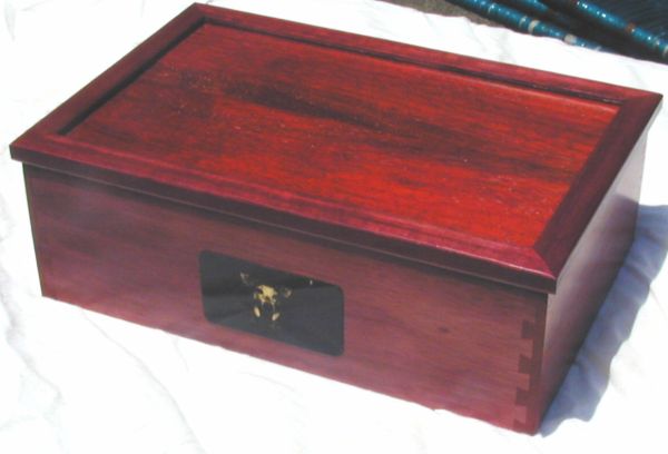

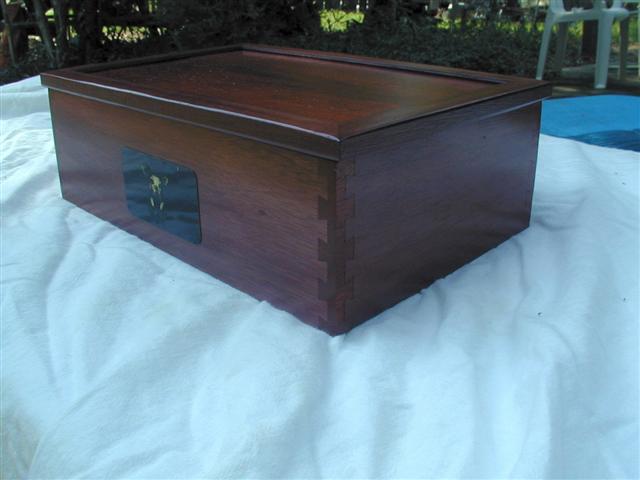

    The daughters cherished Brandi had to be put down recently and she asked me to make a simple box for the ashes.
    Sorry about the pics, I'm giving up taking decent shots of small objects with my camera.

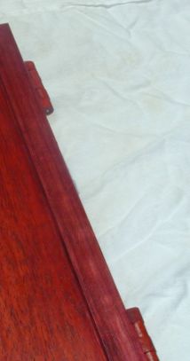

    The box is Purpleheart with Padauk cornerpost dovetails, a Padauk bookmatch panel in the lid and Padauk wooden hinges. All of the joinery was done with an Incra Ultra. The finish is 3 light coats of Waterlox Satin buffed with 0000 wool between coats and buffed with a piece of brown paper after the final coat. Then a coat of Ren wax.
    We had a laser engraving of Brandi done at a local trophy shop.
    Thanks for having a look.

    Beautiful box, Ken. Shame you had to build it for such a purpose.

      Nicely done Ken, especially the hinges.

                Excellent work, Ken. Great looking dovetails.

                    Yep, incra all the way, and well done. Never good to lose a pet, but you honor the memory with that piece.
