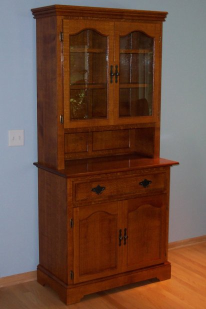

    We needed something for LOML's china, but we had a very defined space in which to put it. The basic shape has its origins in U-bild plan #667, with so many cosmetic and structural changes such that it's nothing like the original. I changed the proportions to make them more appealing to the eye (a little taller at 72") and a few inches wider from the front at 36", and a few inches deeper),
    Some construction details:

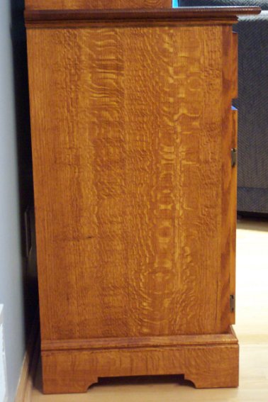

    Wood: Quartersawn red oak is the main material. Some is bookmatched as can be seen in the following views from the sides. The bookmatch didn't quite have the desired effect, but it's still visible. I like the more subtle ray fleck of QSRO versus QSWO; sometimes the ray fleck can be overly obnoxious.

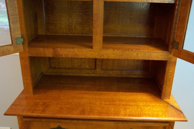

    I used flatsawn red oak for interior pieces (e.g., hutch shelves). The shelves are joined to the hutch sides by using sliding dovetails. The hutch is joined to the buffet top with sliding dovetails, no glue. The top of the buffet then attaches to the buffet, so that I had a two-piece unit.

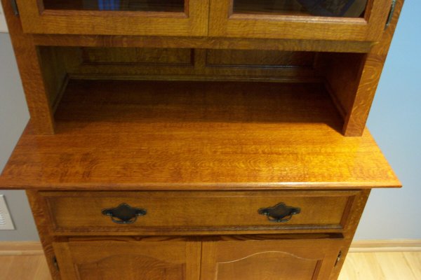

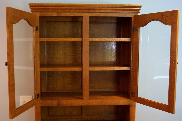

    The back panel and panels in the doors of the buffet were also bookmatched 1/4" stock. I used frame and panel construction, with the Woodline Ogee raised panel router bit set. I also used that bit set to make the glass doors for the hutch, and routed the backside of the groove that the panel sits in so that I could install glass (1/8" tempered). The glass is held in by retaining strips; the top retainers were bandsawn to closely fit the curve of the top stile.
    The crown molding is two pieces. There is a cap molding of oak with half-round top and bottom. The main piece was made from QSRO, using Holbren's outstanding 5-piece molding set. That bit set worked great, and in retrospect, I wish I would have wringed the wallet a little tighter so that a few more dollars would have squeezed out toward the 10-bit set. I ripped down some of the molding to make a transition between the buffet and the base, and the remainder was for the trap moulding that lines the inside of the union of the buffet top and hutch as shown here:

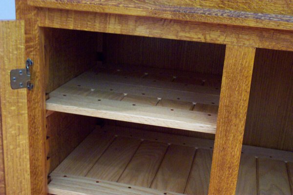

    I used a method I've seen on NYW for the shelf support construction inside the buffet. Initially, I was going to use shelf pins, but I wanted split shelves left and right, so I came up with the following system:
    The shelves are flatsawn red oak, pinned with some padauk plugs. They are ship-lapped left to right, and have a chamfer on the edge between boards. I don't know why I chose padauk. . contrast is nice, I guess. The shelves simply set on cross supports that fit into angled slots. One thing I wanted was the option to have one shelf on one side to accomodate tall things, or at least be able to place odd-height items on both sides, but not lose space. So, I made two half-shelves that can be rotated and fit so that we have three full shelves.
