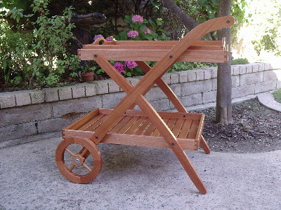

    I'm finally going to call it done. It's a wedding gift for my niece.

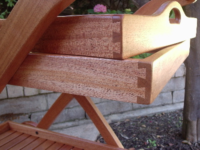

    It started life in my shop as two 8/4 sticks and one 4/4 stick of mahogany. The stock was milled to 1-1/8" for the side braces and wheels, 3/4" for the fixed tray sides, 1/2" for the removable tray sides, and 3/8" for the tray slats. The bottom tray is fixed and the top consists of a fixed holder with removable tray. I used dovetail joinery on the trays becuse, well because I wanted it to be fancy.

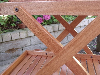

    The side braces are formed with half-lap joints. Everything is held together with connector bolts so I can break it down for shipment to their home in Florida. I fretted for a long time about the hardware for this, but didn't see a really good alternative.
Name:	side brace.jpg
    Last, and definitely least, are the wheels. The four rim pieces are held together with splines. The spokes, hubs, and rims are glued together. I just could not resist the challenge, but the wheels were very complicated and difficult. There are not many nice commercial alternatives, but the work required for these was too much at about half the project time.
