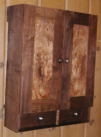

    DVD Wall Cabinet
    This is a wall cabinet that was mostly made to use a pair of bookmatched spralded sycamore pannels I had. The rest of the cabinet is made of walnut. The finish is 3 coats of Watco danish oil. It's hung using a french cleat. Thanks for looking.

    Good going. Clean design.
    Art
      Nice work, Don. Those doors are georgeous!

        Very nice Don. Good use of those panels.
          Very nice.

            The doors are really nice. I'm liking that sycamore.

              Very nice work Don. It looks great.

                You really captured the beauty of those door panels. The contrast with the walnut is very creative. I like how you planned the inside to store with using all the space.

                  That's a great job, Don. I like the color alot. How did you join the door rails & stiles?

                    Excellent job. The doors really grab the eyes attention.

                      Well done Don - good looking, and useful too.

                        Real nice job, Don. Beautiful bookmatches.

                          "I like how you planned the inside to store with using all the space."
                          Actually I didn't plan all that well, I didn't plan on the european type hinges taking up space that's now unusable. Hopefully I'll remember and won't make that mistake again
                          "How did you join the door rails & stiles?"
                          I think it's called "stub tennon and grove". I cut a 1/4" X 3/8" deep grove in the rails and stiles to fit the pannels then cut 1/4" X 3/8" long tennons on the ends of the rails.
                          Thanks for all the nice comments, I like the doors alot but there are some things I would do differently on the cabinet design if I had it to do over again.

                            I hate to rain on the parade, but the big problem I see is that it looks like it's running out of room fast.
                            Otherwise, looks great!
