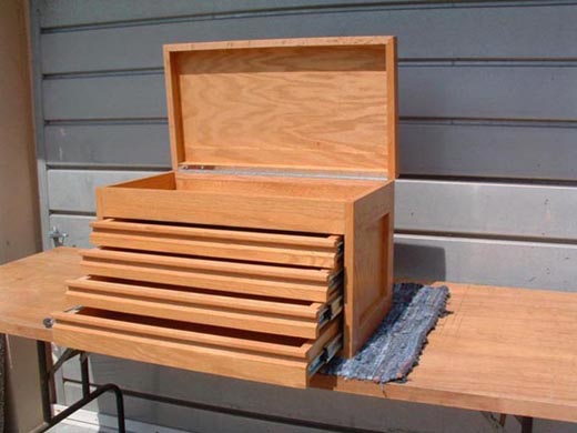

    This toolbox started out as a whim for a place to store "special" handtools. and some of my car buddies saw it and I took orders making several with different woods and trim details. I carved their names, date, and fabrication number in the lid and signed each one. The "personal" touch brought a few more $'s. It's a lot like the "red" tool box, except slightly larger. It's 26"w x 16" h x 14"d. Thought I'd show it, maybe give you ww's an idea.

    Excellent work!! I can see why they are lining up!

      Sweet! Nice work. How did you do the drawer pulls, please?

        Wow. I'd better not show those pic to my wife or she'll want one for her silverware. Beautiful work.
        Bob
          Almost to nice to put tools in. Bet every tool gets a good wipe down before being placed in side.

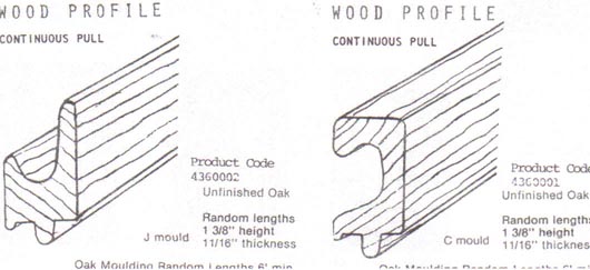

            Somehow I knew someone would ask about the handles. They are a moulding usually sold to cabinet shops in the two profiles shown in the attachment. I usually cut off the spline at the bottom and the front lip at the same time, so the handle can be edge glued to 3/4", and sanded flush. The 11/16" mentioned is what's behind the front lip, so mounting to 5/8" melamine would flush it out. It's sold as random lengths, usually at least 6'.

              Excellent work!
              Karen
                Very nice!

                  Very nice! As a former mechanic that hits the spot. Do you have plans or drawings?

                      Thanks for the info on the handles, good idea. Nice work, you should share at least your first name so that we can give you more personal atta-boys.

                        Beautiful work. It looks great.

                          Nice work. You may want to post an order blank.

                            I like it a lot. Might have to copy your ideas!
                              Fantastic looking chest! Gives me lots of ideas, just no more time.
