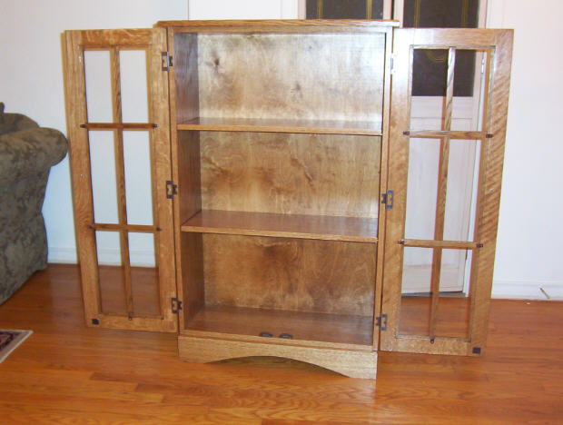

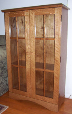

    Here is a craftsman style bookcase I just completed. The plans are from "The Complete Book of Woodworking" cited by several others on this forum. The carcase and shelves are 3/4" white oak ply with the doors and base qtrsawn white oak. Biscuits join the carcase and the door rails & stiles.
    The top has solid edge banding with a chamfered edge. The other exposed ply edges have iron-on white oak veneer.
    The finish is Minwax "Early American" stain with 3 coats "Tung Oil Finish", 0000 steel wool rubs between and a top coat of paste wax.
    The doors have 1/8" tempered glass panes for child missile safety. I went with no-mortise brass hinges from Rockler instead of the standard butt hinges (and mortises).
    Other than taking WAY longer than I wanted or expected, I totally enjoyed this project. (It's not a race...) Thanks for looking.

    Bookcase Lessons Learned
    Got some significant chip out/tear out when planing the quartersawn white oak to final thickness, even with taking very shallow passes. Next time will try wetting the boards.
    Always check measurements, joints, etc. on test pieces even when using published plans. The plan called for #20 biscuit slots to join the rails & stiles for the doors, but the joiner cut was wider than the 2 1/2" rail width, which would have left exposed biscuit on top & bottom of the rails. I switched to smaller biscuits in this instance.
    My first attempt at hand routing the half-lap dados in the thin muntin strips did not go well. I switched to the table saw stacked dado for the 2nd batch... I need some more practice mastering the router.

    nice work, Kendall!
      Nice design, excellent wood and craftsmanship, Kendall. I'm looking forward to the description.
      ken
        Very nice, just needs books!

          Very pretty.

            Nice work Kendall, I love the mission syle and that is a great piece!

              looks great, kendall. nice job! what kind of finish did you use?

                That is a beautiful bookcase. Very nice work.
                  That piece looks great! The grain on those doors is exceptional.

                    That looks awesome, have to add that one to my to-do list.

                      Beautiful craftsmanship and choice of wood!

                        very nice.

                          Very nice!
