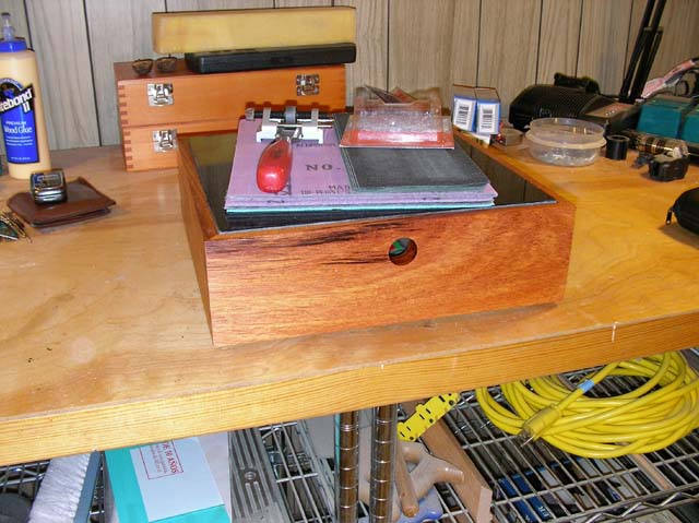

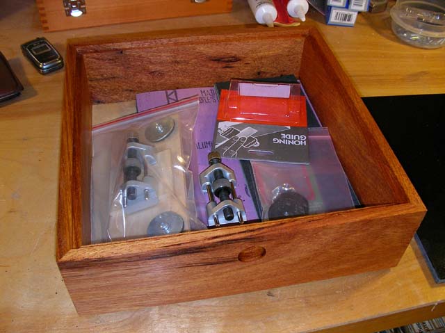

    I've gotten into sandpaper sharpening ("Scary Sharp") and wanted a place to keep all my sharpening stuff. I had some cut-offs of Afzelia that I purchased at Rockler and came up w/ this.
    It is a 13" box that is approx. 3-3/4" tall. It has a rebate to accept the 12" square granite floor tile or piece of float glass I use as my plate.

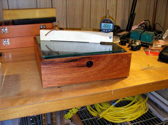

    BTW, you'll note that I'm using my jointer knife-setting jig to check the flatness (sorta) of my plates. The float glass is really almost completely flat. I can get a .0005 deviation at one edge. The granite floor tile is off by up to .0015 at one edge. I'm going back to Hobo w/ jig in hand this time to test the tiles before I buy them--I wonder if I'll get strange looks).

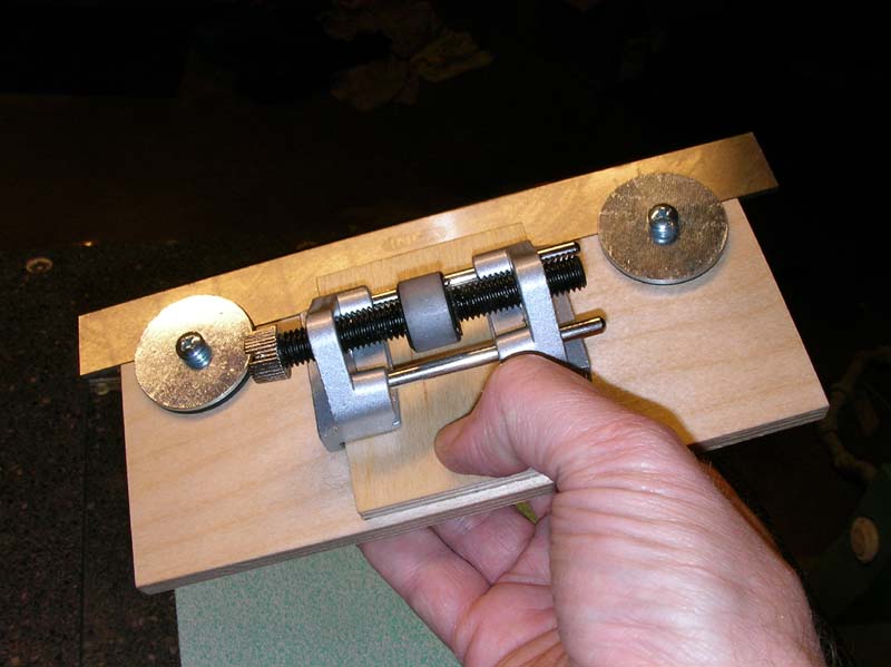

    I also decided I don't like the honing guide for hand tools. It works fine for the jig I made for my jointer knives, but it doesn't hold my smaller hand-tools very well.

        Great idea to keep everything contained.

            Nice Idea, but how'd you take a picture with your left hand? (see the bottom pic)
