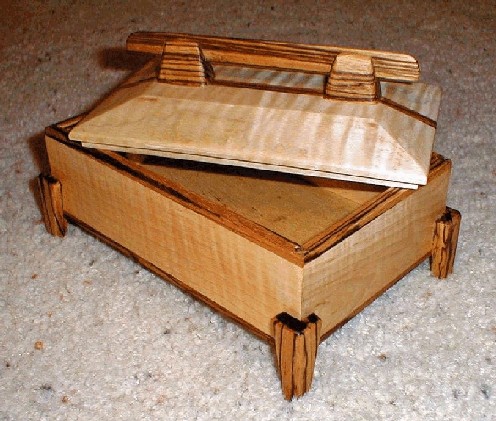

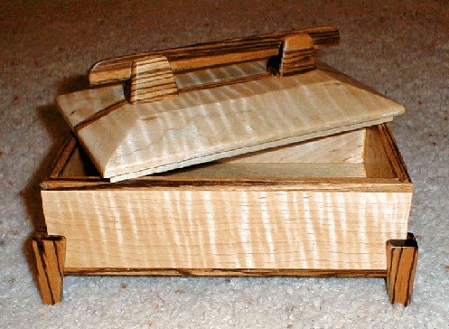

Here's my first project using tiger maple and zebrawood. Learned you get tearout on figured woods. Solution was to dampen the maple with water then plane in tiny increments. The plan from Wood Magazine called for using a belt sander to shape the legs, which burned the Zebrawood. Next time I'll bandsaw close to the desired profile and beltsand to the final profile. Used 3 coats of polyurethane with steelwool buffing between coats.
Contemporary Keepsake box- tiger maple

Very cool. Figured wood is a pain in terms of tear out, one more reason for a drum sander. ;-)Keith Z. Leonard

That is so cool, from the shape to the choice of woods. Very well done.Larry R. Rogers
