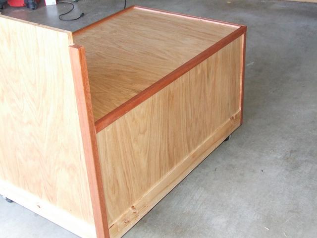

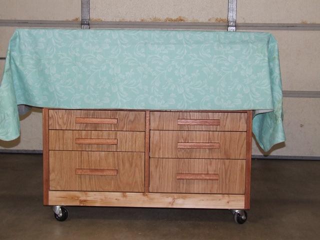

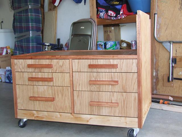

    Heres a few pictures of my first cabinet.
    The base is a 2x4 frame with 2 sheets of 3/4 ply inlayed.
    The sides, rear & drawer faces are 3/4 ply with the drawers themselfs madeup of 1/2" ply. the edging trim and drawer handles are made from 5/4 mahagany with the vertical mahagany bisketed to the ply.
    In building this i found using a 3/8" forstner bit worked quite well for a pocket hole followed by a pilot hole witch in a few places (drawers, center support)
    On the right side the vertical mahagany supports the bt rails & will be used for support for any additions. The rail will slide over the supports.
    I was leary about not having the drawers un-uniform but decided to size the drawers to spefic tools that they would be used for. plam sander, belt sander, router base, screws , drill drillbits , router bits ect....
    I got the wood from a local yard with the ply being seconds,5/4 10.00 for 10',wheels from HF,drawer rails from lowes,coated with antique minwax. An overall cost @140.00.
    Its much easier to start at the bottom and work your way up but in this case I had to start at both ends and work toward the middle. As I wanted rail support and may add a rail track slide for the bottom of the rails. Which will fit in the underside T-slot.

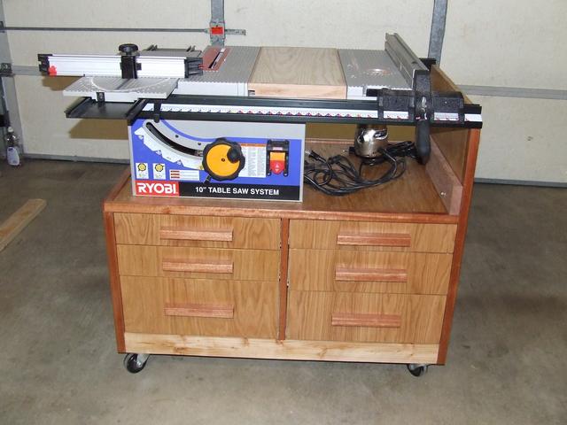

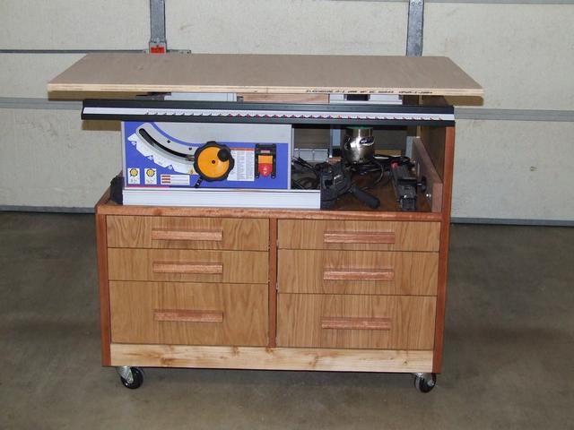

                            BT coming to life from a rest.
                            Heres several pictures of the BT mounted to the cabinet with close to the same footprint as the rails
                            The rails are mounded to the right, leaving i hope easy support for rail extention.
                            I may build a router table later on the cabinet
