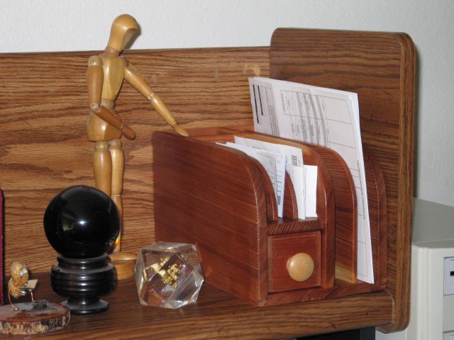

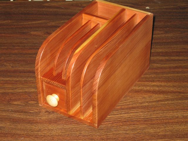

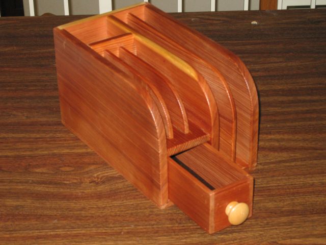

    I was getting tired of my recipts and bill printouts getting blown around (down here in the Sonoran Desert, ceiling fans are not a luxury when the weather warms up). So I whipped up a desk organizer to hold them until such time as I get around to balancing the books and filing them.

    I used some redwood that I had laying around from another project. I wasn't bothered too much about the few streaks of heartwood on the edges of a couple of the pieces, since I just wanted something utilitarian. I told myself that it adds a bit of interest to the piece. I stuck in a drawer mainly to fill the space underneath the small recipt slots. Feeling lazy, I spritzed on a couple of coats of spray poly to finish it.
