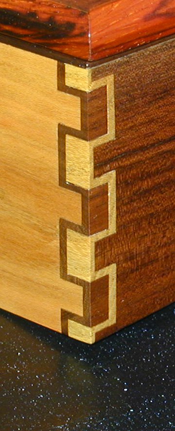

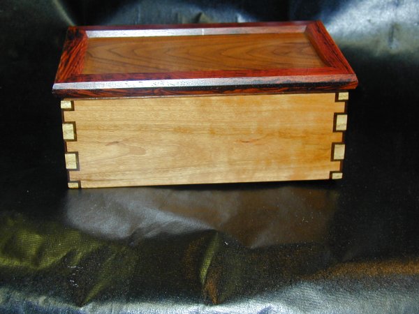

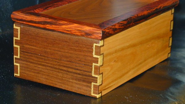

    This is my first result from an Incra Pro jig. They call the joint a Double-Double Boxjoint.
    Well, originally the box was bigger, but 2 'learning experiences' caused it to get smaller.
    It ended up around 8 by 6 and 3 1/4" high. It's made of Cherry, Walnut, Cocobolo and Sassafras.
    I used Sassafras and Walnut in the double joints, I'm thinking now that I should have used Cherry instead of the Sassy. The top is a Cocobolo frame chamfered on all corners with a 1/8" thick Walnut panel. The Walnut panel has some nice curl that doesn't show in my bad pics.
    The finish is 3 coats of satin Waterlox, buffed with 0000 steelwool between coats.

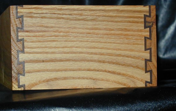

    This is an unfinished box showing the Double Dovetail Incra joint.
