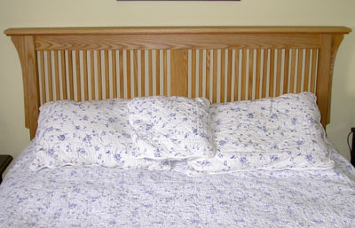

    here are a couple of pics of the mission style headboard i just competed:

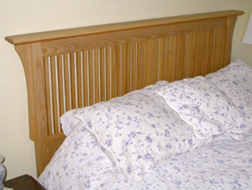

    i made the headboard using White Ash and finished it with Watco Danish Oil

          Very, very nice. What flavor of Watco did you use, Natural?

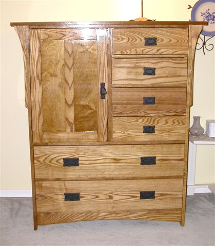

              stan - the flavour of watco danish oil i used was 'golden oak'. pat, as for other matching pieces, yes, i am working on a nightstand right now. i have already completed this matching dresser for myself:

                  Nice work Rick! I really like choice of Ash and the light colour finish.

                    Excellent job Rick. That white ash and golden oak stain is a winning combination.
