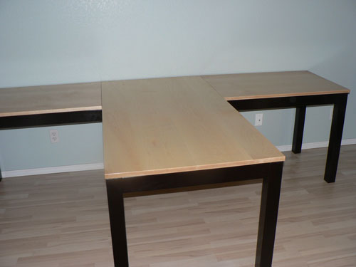

    This inspiration was from the 2006 Room and Board Catalog.
    The reason for the two returns is so the wife and I can work at the same time.
    Desk is 5' x 2 1/2'. Returns are 3' x 2'.
    The frame is ebonized poplar. two coats of black dye, a coat of General Finishes Java Gel Stain, and 4 coats of high gloss wipe on poly. The tops are 7/8" maple with 6 coats of satin wipe on poly.
    The legs are 2 1/2" and the rails (apron) are 3" wide. The joinery is floating tenons 3/4" thick mitred into the legs and 1 1/2" deep into the rails. The returns are bolted into the side of the desk.

                          Is the top photo an "after setup" pic? I notice a cabinet with drawers on the right ... did you make that as well?

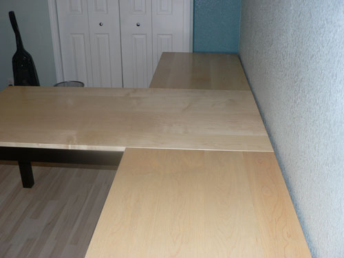

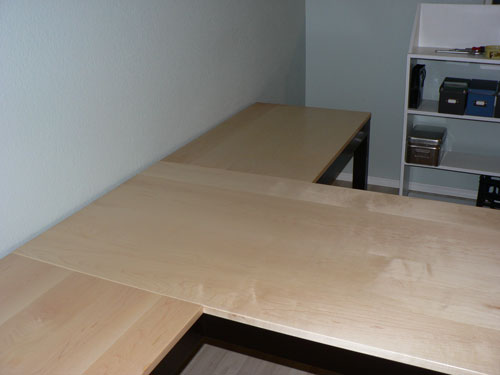

                            The top photo is from the Room and Board catalog. Since the original posting, I have finished setting up my computer. I have a laptop on the left return and a desktop on the right/middle. I have a large Antec server case that fits nicely under the desk. I also have two filing cabinets that fit underneath the returns.
                            The one thing that I hadn't considered beforehand was a keyboard tray. With a 3" apron and a 7/8" top, a keyboard tray would be too low.
