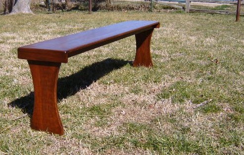

    Kitchen Bench
    Needs a couple more coats of poly but here it is.
    That's a real nice bench, Randy. As I say too much, I'm not a fan of stain, but that piece is an exception. It really looks good.
    ken
      Very nice. Don't you just hate waiting for poly to dry so you can add that fianl coat??

            Probably a boring question to you true furniture builders but do you spray the poly on or brush it on? Also how many coats should a person put on something like that? It is beautiful by the way and I didn't realize that it was stained and I too am not a big fan of staining but that does look awful nice. Great job!

              I use wipe on Poly. I know its not as durable but it turns out way better for me. The bench is made out of lyptus with dark walnut stain. Two coats so far. I will pry put 2 more on. Its been over a week since the second coat. But im trying to finish a TV stand made out of MDF and I painted it and the primer I used was old and clumpy. I just sanded out the chunks but the paint ened up looking pretty bad. Some parts are glossy others are not. So Im gonna paint over it with flat paint and see if it turns out any better.

                Thank you for the reply onedash. I may have to try that wipe on poly some time. I'm never happy when I brush it on but don't have a spray setup or even a place to do any spraying anyway so that may be the way to go. It sure looks great.

                        Your Bench looks very nice, I especially like the color.
                        The feet appear to be somewhat close together.
                        Is this going to cause a problem with stability?
                        Normal rule of thumb for a bench is that the feet need to be about 1" wider than the seat at the very least (1/2" fore and aft).

                          Very nice, very nice. I made one for Thanksgiving, and have used it ever since. My thoughts on the feet also, They look a little narrow...hope it works out all right...
