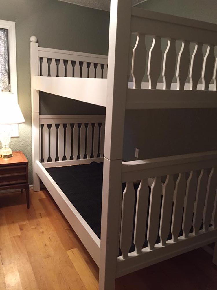

          Purchased for $100? Didn't purchase new? That is what is wrong with it, probably beat up before you got it.
          What do we like about it: for most of us, precision cabinet making quality CUTS at job site saw price. Does quite a bit. Not made for rough and tough throw it around in the back of the truck. But Take care of it and it is a sweet cutting saw. Don't force it or try to build a house with it in a week.
          Below is only one item that I made with the BT3000. Made numerous things with precision cuts and not problems.
