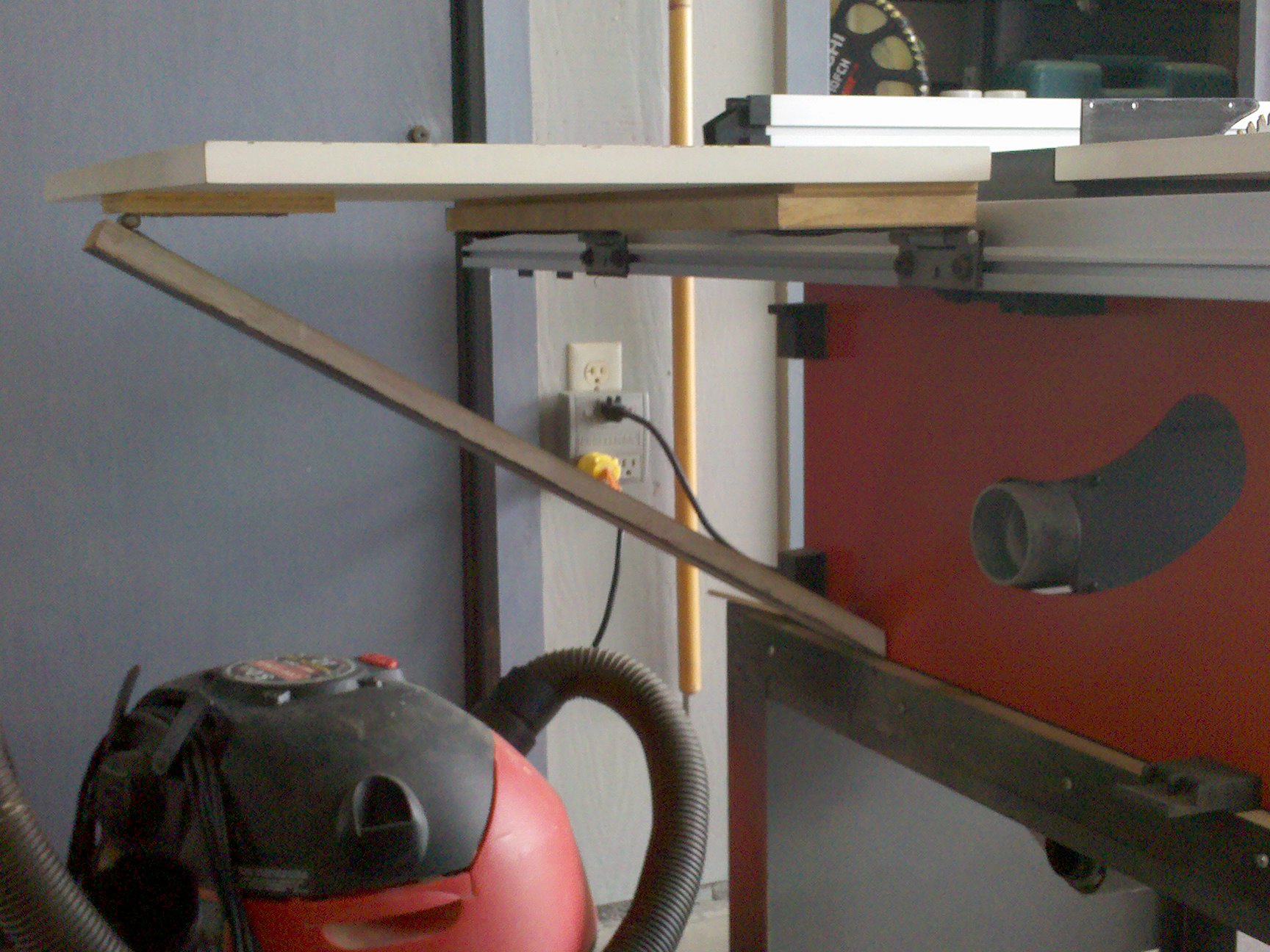

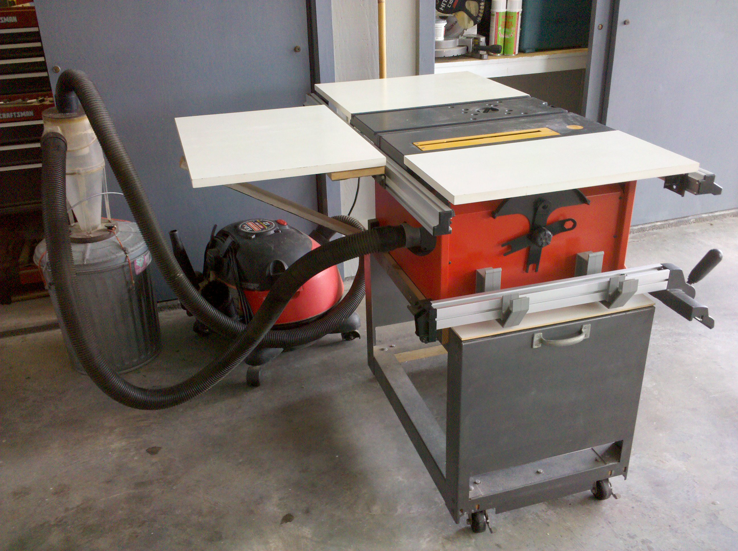

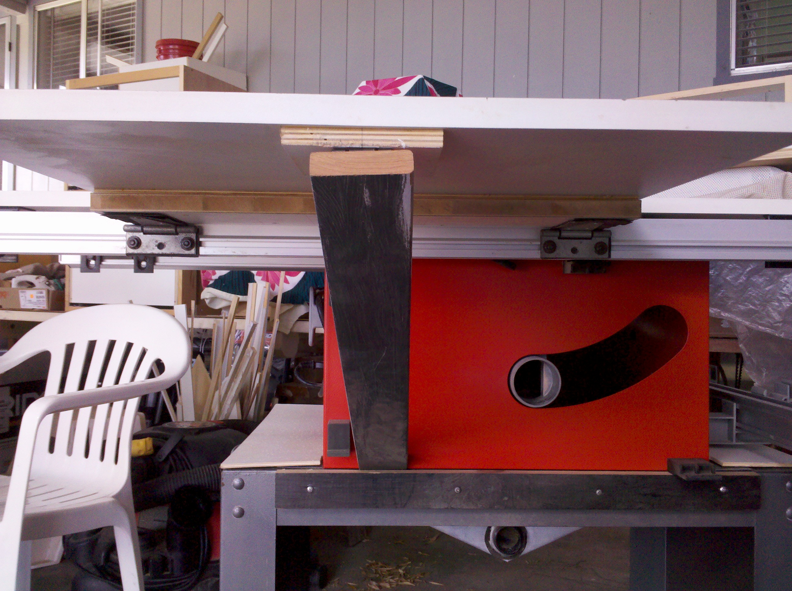

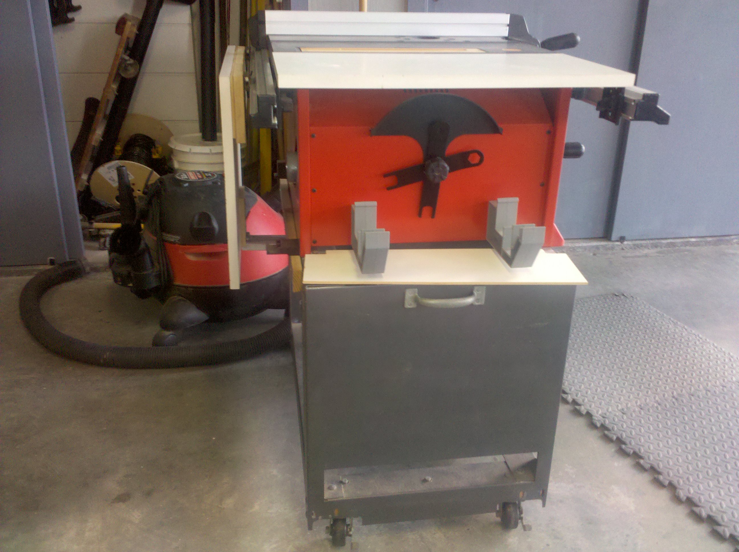

    Originally I had this on my BT3000. As you can see I mounted my 21890 onto the BT3000 base and mounted the BT3000 to the 21890 folding stand so I can use it as my jobsite saw. Anyway, my outfeed table is 17" X 23", odd measurements probably a scrap that was handy but long enough to support a 4' stock being cut. Its held up with a 1 X 3 sitting on a 1X3 ledger screwed into the base. Made it level with the top of the saw no matter where you placed the saw. I have it placed so that in case I want to use my SMT it won't be in the way. You can fold it down for easy storage.

    TS w/outfeed table & clearvue mini cyclone
Name:	2010-07-16 12.05.57.jpg
    1 X 3 support leg resting on ledger, table & support leg held with 2 1/2" strap hinges.

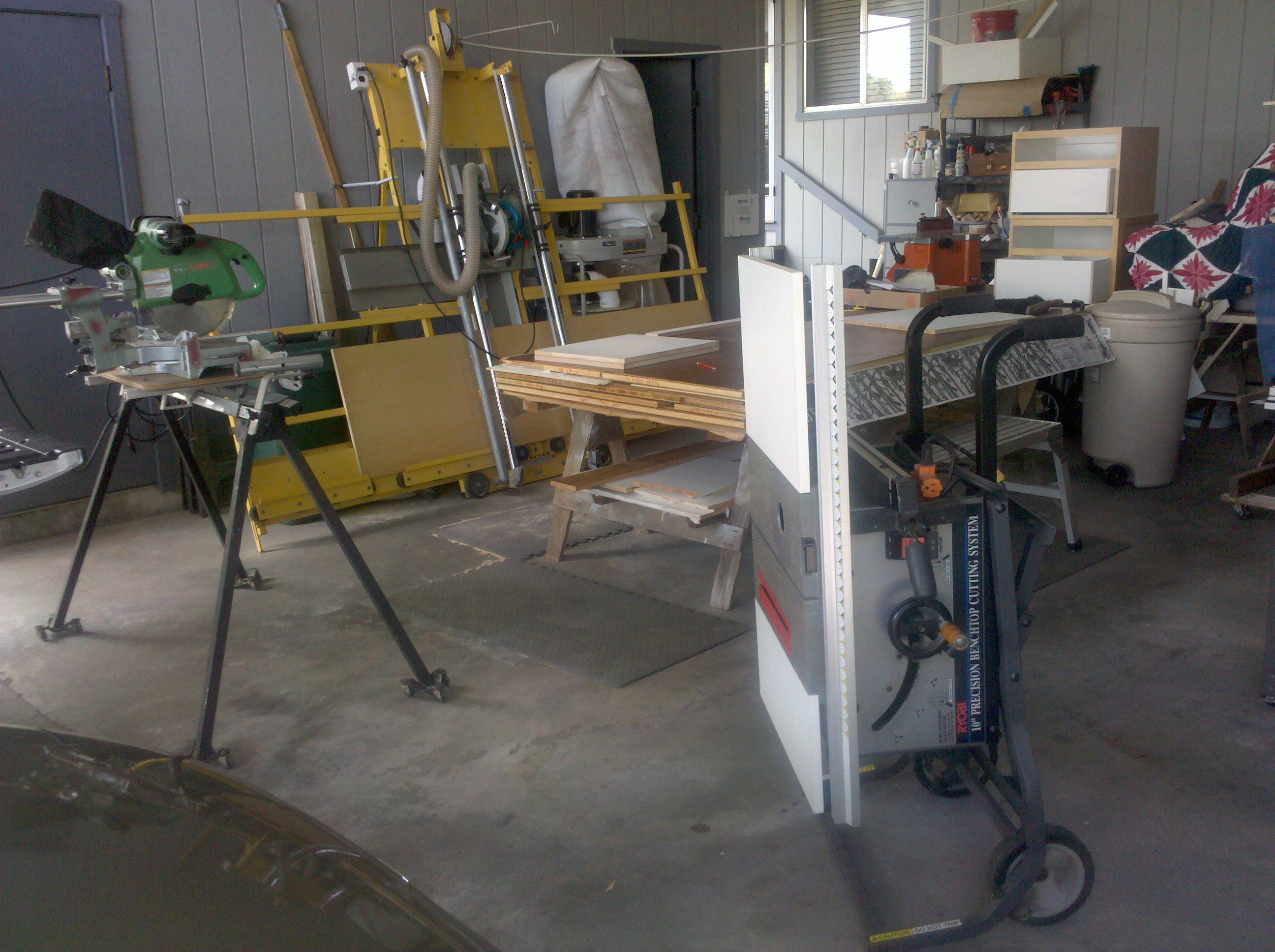

    Table lowered for easy storage
Name:	2010-07-16 12.23.58.jpg
    BT3000 on folding stand

            Jabe, What I can't see from your photo is where you place the support "leg" in the stored position. In the third pic, it appears to drop down and under the saw body. Is that correct?
            • jabe
              • 577
              • Hilo, Hawaii

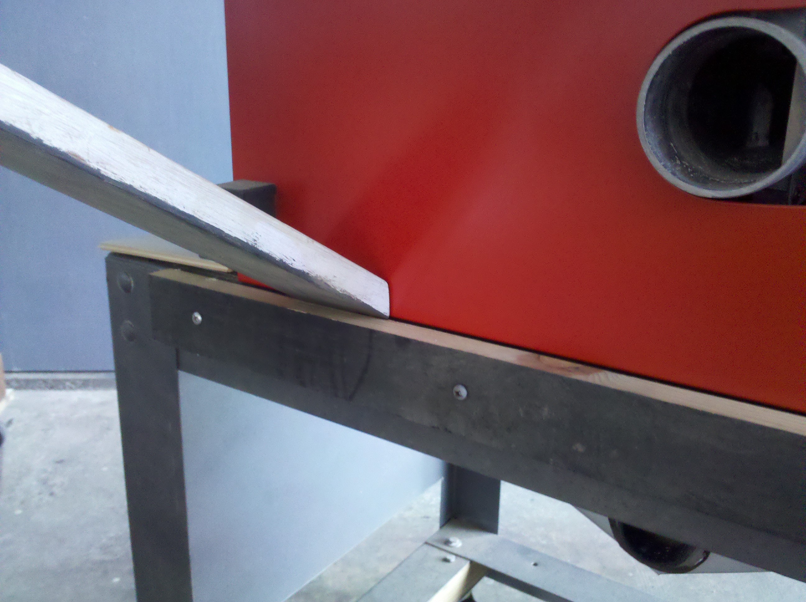

              Krogers, yes the top drops dn. and the support leg just goes under the saw. I added a 1/2" plywd spacer on the bot. of the table then the 3" strap hinge attached to it & support leg. The 1/2" spacer allows for clearance of the knuckle of the hinge & prevents the leg from opening more than 90 degrees when the table is lowered. I also added 1" spacer on the bot. of the table @ the rail end to bring it level with the top of the saw table. The spacers were made with scrap 3/4", 1/2" & 1/4" plywds. A simple idea that works. I'll take some close-up pictures and post it.

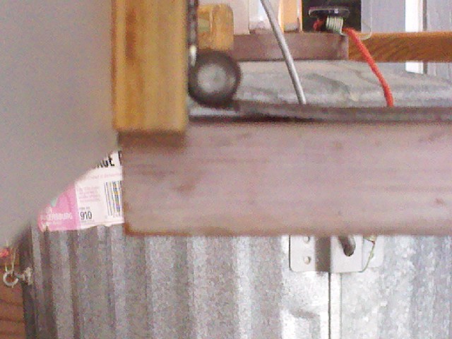

                close up pictures
                Here's some close up pictures.
ID:	785391 1/2" plywd spacer with strap hinge
ID:	785392 front 1" plywd spacers with roofing felt as shims
ID:	785393 close ups of leg with table down, table acts as a stop so the leg won't open more than 90 degree

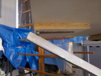

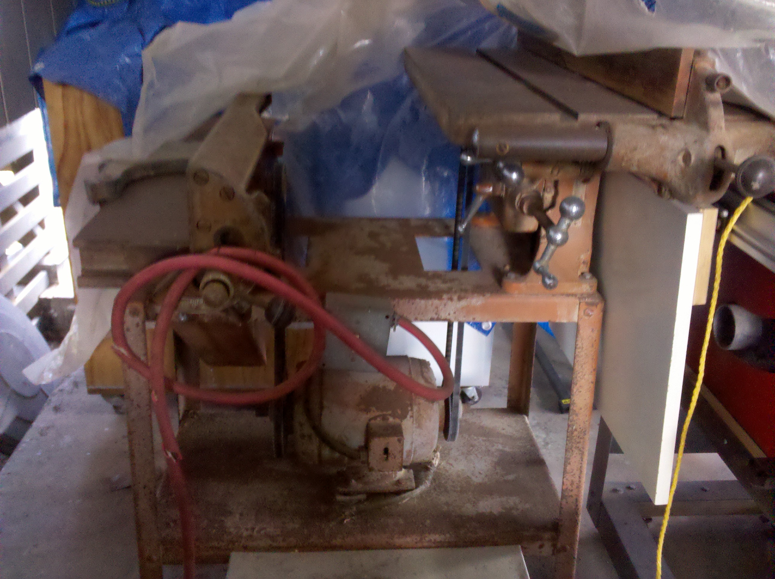

ID:	785395 Saw tucks away under my old Rockwell Delta 10" tilt top TS & 6" jointer combo.
ID:	785396 undrside view of out feed table
