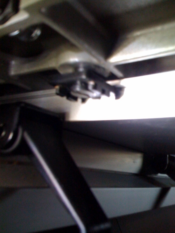

        Ok...the table slides about a 1/16 in the front after full adjustment. The second statement is very well true, because that is happening here. I already followed that guide to try and adjust before I opened this thread. I have attached a couple of pics showing the Left Front and Left Rear adjustment screws. As you will see, I am wondering if the Left Front is correct....the Right front is the same (besides that it is not an adjusting screw).
          Your left front is missing part of the glide. Look closely at this pic....
          • rdr8887
            Thanks for the input. Both the left and right front are missing the slides for some reason. No wonder it won't adjust.

              They DO need non-broken slides. Won't work without them. This is much better to fix than when the holes are drilled improperly. Now we are back to only two SMTs with holes drilled improperly that I am aware of. . . and I still have the one that came on the 3100.
              I will give a hint on using the SMT: On the SMT base, there are two slots. Make it a habitual practice to push the black tab slide from the SMT table - down into the slots EVERY TIME you remove the SMT from the rails. If you don't, there will be a time in which you sit it on the floor in a vertical position, or you hold onto the base - and in either case, the base and SMT top will drop, move, slide and result in a broken "slide". DAMHIKT.
