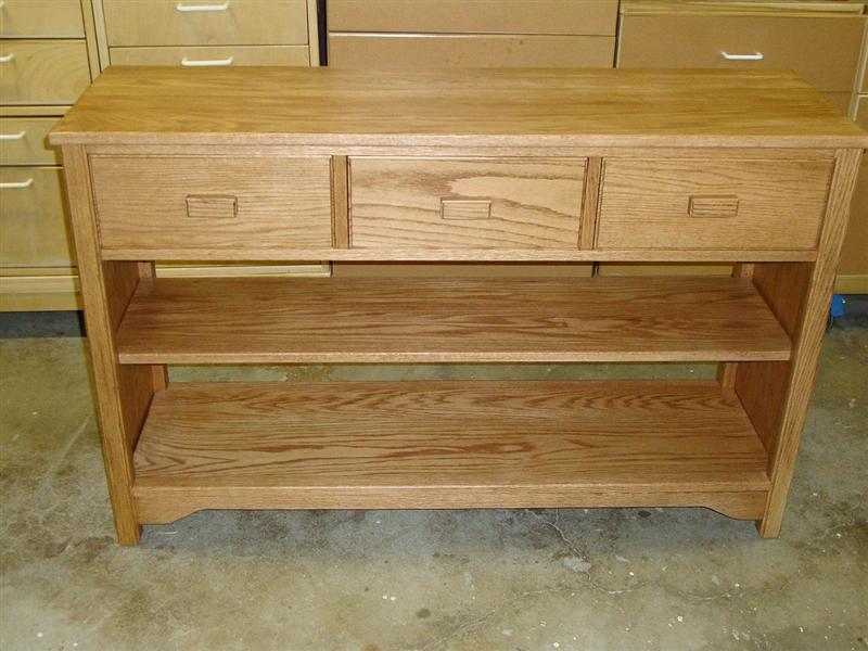

      I have had good luck with this product . . .
      http://www.woodcraft.com/Product/200...Bison-Wax.aspx
      We used two or three coats of the "medium oak" tinted wax to fill the grain, then applied two coats of clear furniture paste wax.
      Here's a picture . . .
      Good luck, Steve
        That's a really nice piece, Steve.
        So you finished with just the two waxes? No other stains or poly?
              Yes, two coats of the Black Buffalo tinted wax and two or three coats of Johnson's Paste wax. We found it important to allow each coat of the Buffalo wax to dry for at least one-half hour, preferably longer. Also, the Johnson's wax should be applied lightly, without any vigorous rubbing -- just coat the piece and allow to set, as above, before buffing,
              I should add that I just finished the piece a couple of months ago so I don't have any feel for how durable the wax coats are.
              Regards, Steve

                I can't say how it will hold on your piece Steve, as it is a table that may or may not be subjected to traffic? But.. I used strickly a coat of Watco on a bed I made two years ago and then applied two coats of Johnson's after a week of cure time. Of course the bed frame.. rails.. etc. doesn't get touched much really but... it has held very well with no need for a new coat of wax yet...
                BTW... I also use the Liberon Black Bison Wax in medium oak on A & C pieces after stain and finish.. Good stuff and probably the best wax formula I have run into in going 38 years. The Liberon 0000 steel wool is also the best steel wool I have used. I use it to apply the Black Bison wax which gets wax on and takes the sheen down to satin in one shot..

                    Waxed finishes offer little to no protection or durability, and cannot compare to an oil base finish (like varnish or polyurethane), lacquer, or waterbase polyurethane. Waxes will dry out and appear differently (mottled). Waxes will preclude using any subsequent film finish.
                      Yep, I agree, C'man, and would not have considered the 'wax only' finish if the table were to get a lot of traffic. But the table will not receive anything near heavy traffic -- it is used mainly as a handy table to put things on and is almost never exposed to moisture (other than in the air) and sliding things across the surface. If it does get scratched or rubbed, then, as Sarge noted, it can be touched up with wax.
                      Thanks to all for the comments. Regards, Steve
