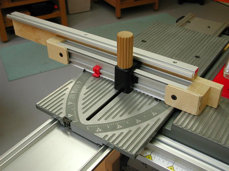

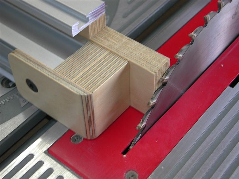

              Roloff, If you are concerned the SMT fence ends the best thing you can do with those IMHO is toss them. If you feel you must have ends PM Rod Kirby and ask if he can email you pics of the ones he made when he had a BT3K...
              These are all the pics I have...
