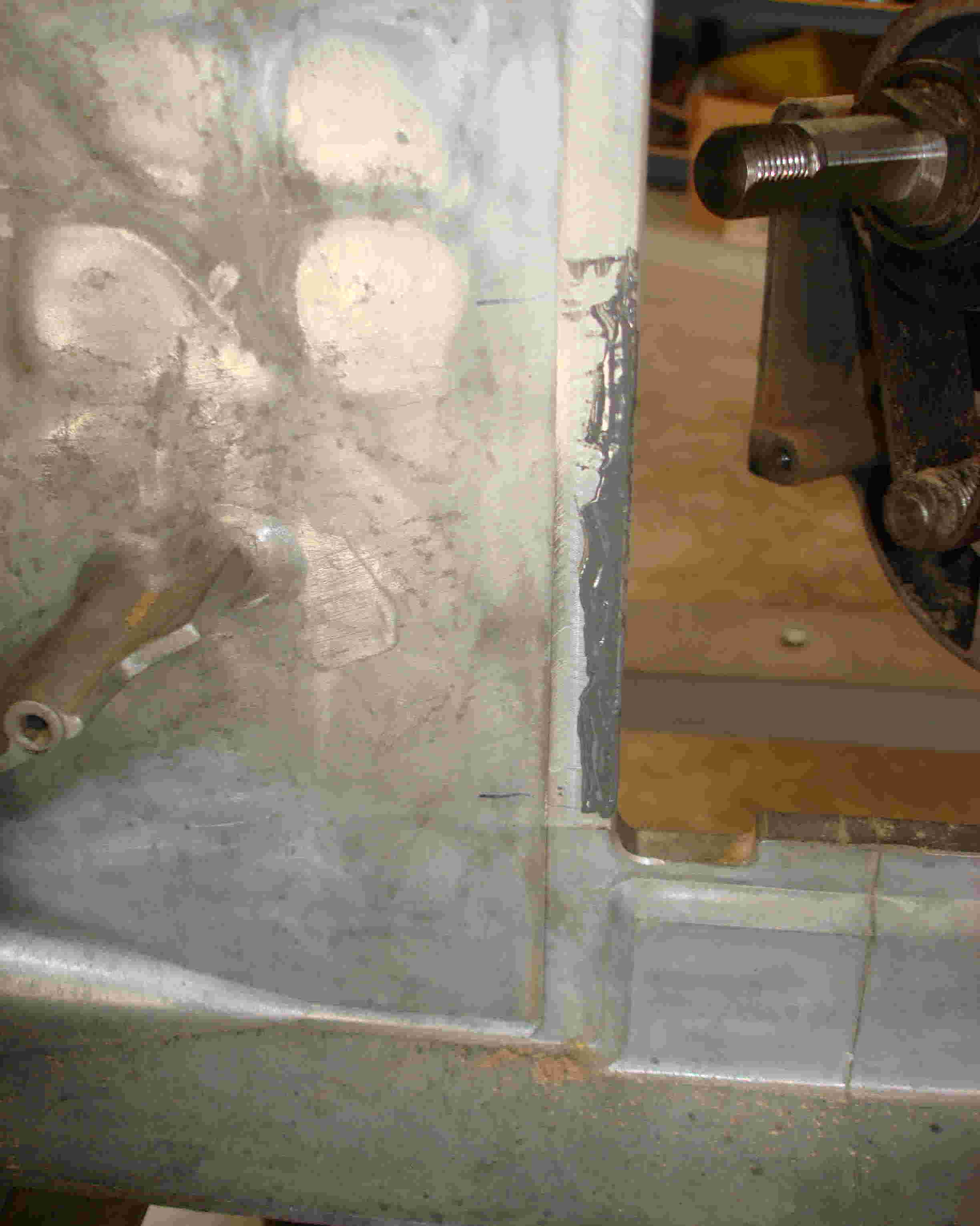

    My BT3000 was a gift from my wife many, many years ago. Because of work and other commitments I have not had much opportunity to use it, until recently. While working on several projects I could not get the fence or the sliding table aligned with the blade. So with a little time on my hands and the information on this site I decided it was time to find the problem. Thinking it was a shim problem, I disassembled the saw. I found a huge gouge in the face of the rear locker bracket. The set screw had worked loose punched a significant dent in the shim and then wore a divot face of the Locker bracket. (I will try and add the pictures.) My question is really now what. Should I replace the locker bracket or is there another solution?

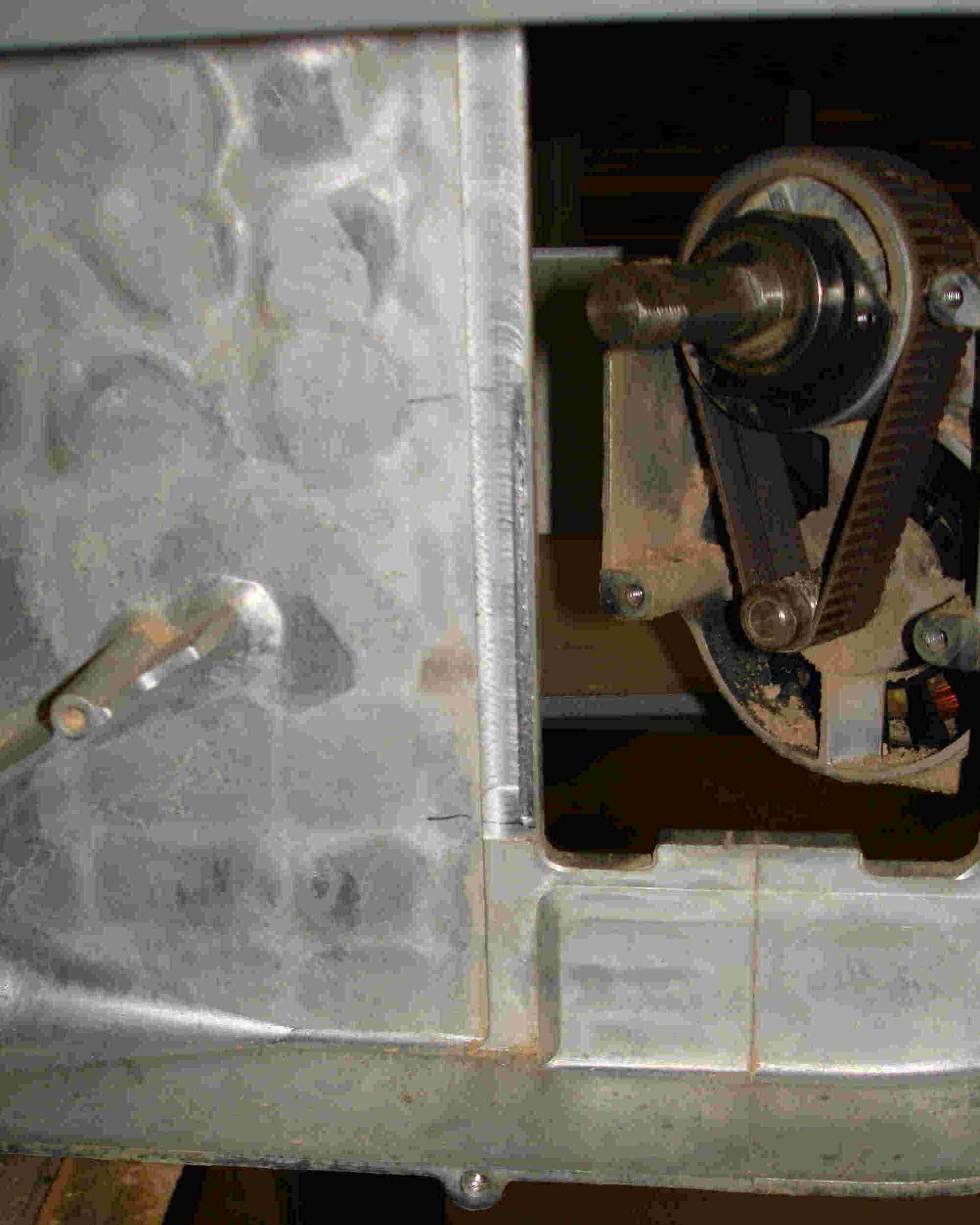

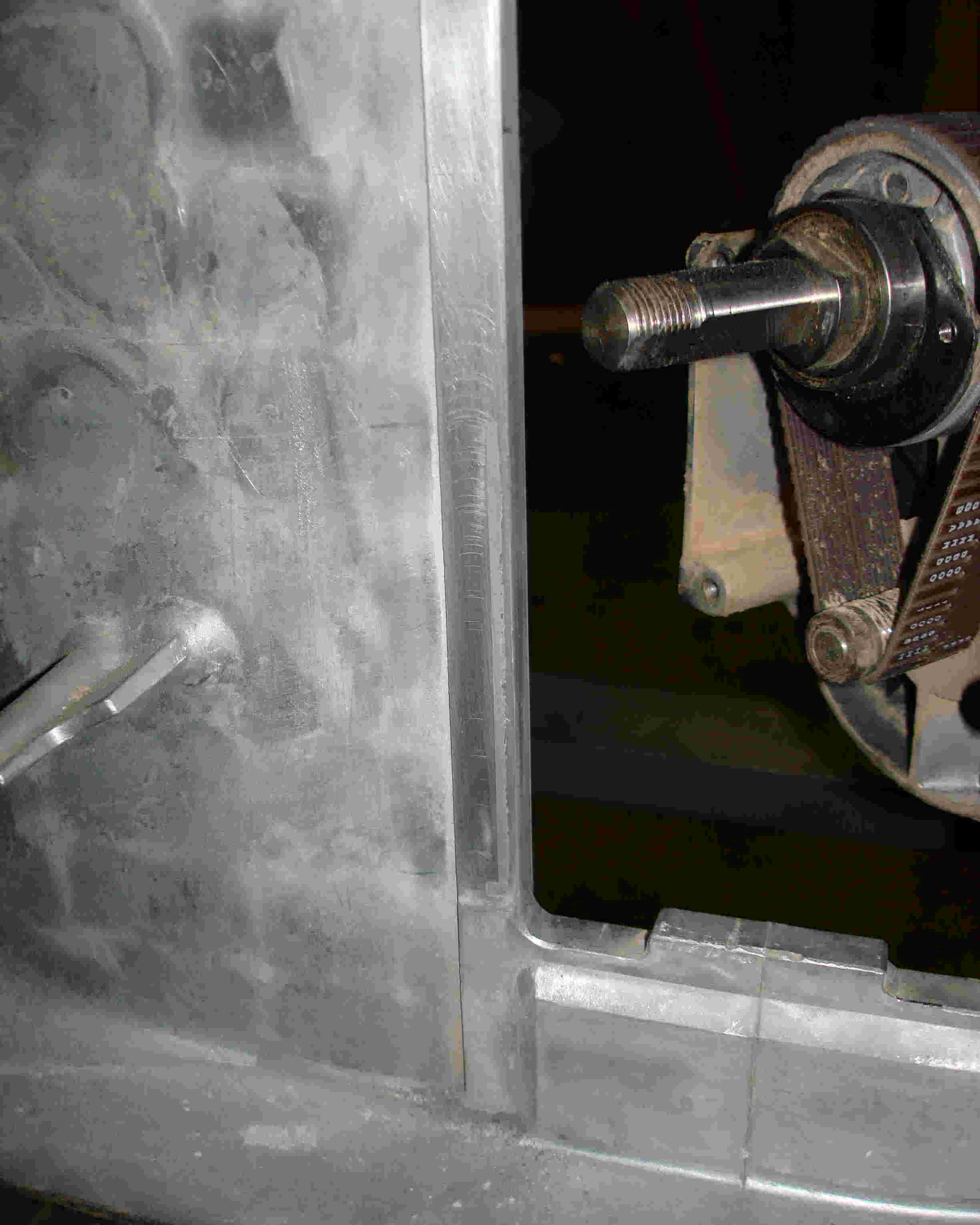

              After the advice from this site (and a couple of metal working buddies) I used JB Weld and some farm yard body work to repair my saw. It seems to nave worked!
              The saw moves up and down better than when it was new. And after a quick check the blade alignment was dead on and 32nd measure. I now have to re aliagn the fence and sliding table. That is the task for this weekend. I will add a report after everything is reset.
              I want to thank “golfeng”, Mark Stripes and Norm Fujino for the information they took time to document. It made a the repair and reassembly go smoothly. I did add the use of a pipe clamp to encourage the bearing to seat enough to get the screws started.
