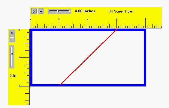

      Just to visualize your description, I made a drawing of the 2 x 4 and cut it at 45°....I noticed that if the fence would be on the left side, the supported width of the board on the table is only 1" while the top side of the board has 3" lying on the blade....I would not feel good with this set-up..
Name:	Bevel cut 45.jpg
      Just not to send you back, here is how I cut a narrow board to 2...I would not do it with the fence on the left side

          Niki, in your drawing above, it doesn't matter which side of the blade the fence is on...there is still only 1" of wood supporting the left portion, and 3" of wood laying on the blade. The difference is that if the fence is on the left, the portion of wood on the right has someplace to go (to the right) rather than being kicked back.

            About the 3" lying on the blade...please have a look at the second picture above (that I'm cutting the 1½ x 1½" into 2 parts...would you dare to make this cut with the rip fence on the left side of the blade...
