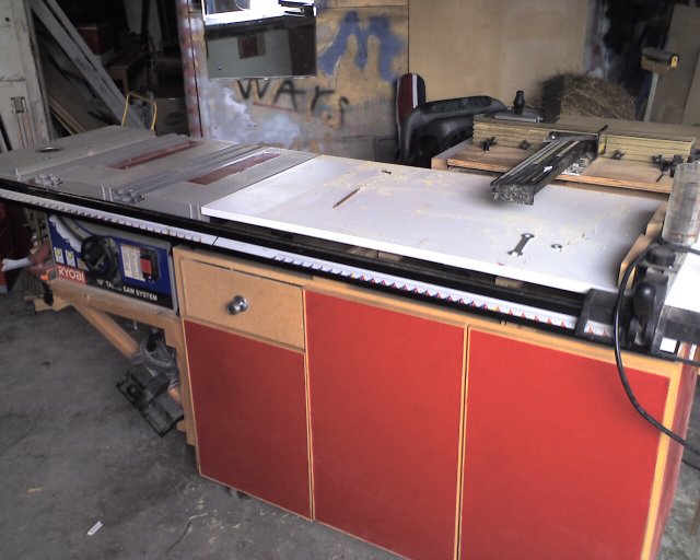

                      • bmyers
                        • Jun 2003
                        • 1371
                        • Fishkill, NY
                        • bt 3100
                        Here is what I came up with to solve similar problems. It's basically 2 saws together. There is another hollow BT top between the rails holding another miter slot. You could do this with just wood also.
