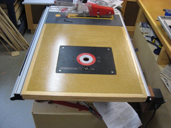

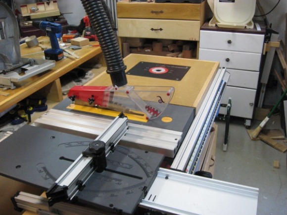

              This is my just completed extension table for the new 21829 saw ( I could have used the extension table for the old bt3100 but the rails are longer on the 21829 and I wanted to take advantage of the extra length. Very simple to build, the table is 2 pieces of 3/4 MDF glued together to make 1 1/2" thick table. Edged with redoak and finished both sides with 4 coats of oil based poly. The table is attached to the rails using aluminum angle pieces and T nuts. I'd say it probably only took 2 or 3 hours of actual "work" to complete ( but I did use the aluminum angle from the old table). I mounted my router switch on the back rail using T nuts also. I think you'll be happy you built the table, I know it's really been good for me in my small shop.
              DonHo
              Oh, and I'm sure you won't mistake my shop for Rod's :-)
