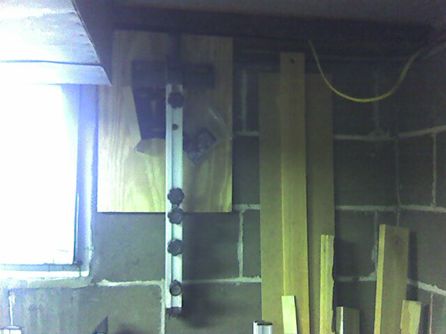

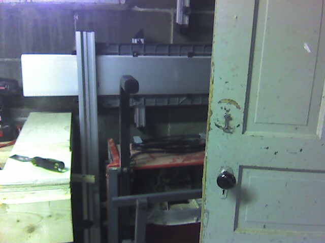

                        I am really surprised at this thread - I LOVE the Craftsman stand!
                        While I can understand it would be a little tight to open sideways in a 5' wide porch, that is a fairly extreme example. Gwyneth, now I can understand your other posts about not liking the longer rails on the 21829. In your particular case, I think it would make sense to swap the rails. I have a very small shop by just about any objective standard - about 10'x11' and I really appreciate the extra long rails.
                        Thinking of it as a contractor type folding stand is missing the real intention. The BT3 series is obviously not built to be bounced around from jobsite to jobsite. (Although it might be a good option for a finish carpenter who was very careful.)
                        The real idea is that after you are done using it, you can fold it up and stow it away in a 2'x2' footprint space. I've attached a few photos to show it stowing behind the door of my shop. I personally hate products with cludgy set-up/take down processes. While you can stow the sliding table, miter fence and rip fence on-board for transportation, I hated doing it for normal use. So, as you can see from the photos. I hang the rip fence on the wall and just attach the sliding table (with the miter fence) attached to the "high" side of the rails and it fits nicely over my workbench bench and just about any work/clutter I have on it. For reference, my workbench is 34" tall and 26" deep. It literally takes me less than two minutes to go from stowed to having wood loaded and preparing to cut. Even less for stowing it away.
                        As for moving the table while it is open, it has always seemed easy enough to me. Just lift by the rails on the left side and roll. If I need to budge the right side forward or back in a tight spot, it is light enough to do so easily. I use the handles when I can. but if it is too tight, I just make sure I have a table attached for support and use the rails.
