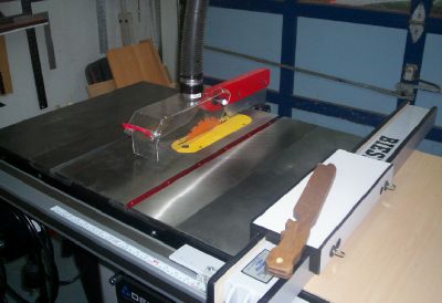

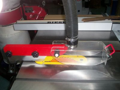

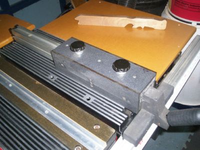

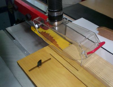

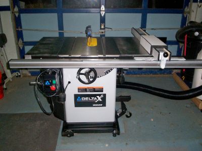

          Thanks IR.. I made some Euro style "crown gaurds" from scrap stock for both and made Euro "short fences" from basically scrap also. I got into an eye opening conversation on saw safety several years ago with Sgain Dubh (screen name as Richard Jones is the real title) who is an English professional WW and contributes to FWW, Wood, and Furniture & Cabinet-making which is the leading English WW mag.
          I walked away with a wealth of info and adapted the crown gaurd and short fence and won't turn on the TS without them anymore. They just make common sense and are a better way as far as I am concerned. They won't be everyone's cup of tea as it is hard to break the tradition of what has been presented to us in the U.S. TS market and told this is your options.. take them or leave them.
          I feel there are better options and as I can't afford to buy the very high dollar Euro machines with them on it.. I will make my own for literally "small change" from the cookie jar and scrap left over from other projects.

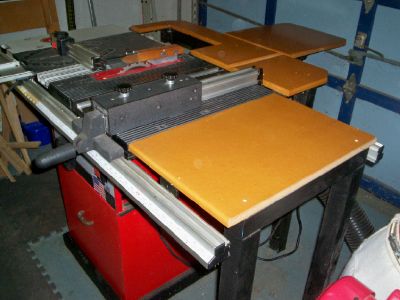

            The BT 3000 base is built to go under the BT from scrap Birch ply-wood and framed with southern yellow pine which is quite stable for constructing any type of framing. Very simple to make and if you get clever the area under the saw can be used wisely.
            I had one of those small, portable refrigerators under it at one time. That would get some attention with visitors the shop when you asked if they care for a soda or cool drink. ha.. ha.. ha..ha..ha..
