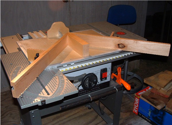

      Something like this?
Name:	Miter Sled bottom.jpg

        Thank you very much for responses and pictures. Just what I needed to know.
