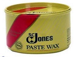

            Johnsons isn't the only brand of paste wax, but a trick to help you find some. Go to a grocery store in an older area of your town, where most peoples houses were built with hardwood flooring. Grocery stores tend to carry it in those area's.
            • Doug Jones
              • Oct 2004
              • 332
              • Indiana
              • Delta 36-444
              Is it Johnson Paste Wax or was it Jones Paste Wax? I found mine at Ace Hardware.
                Nice job Doug except you can still read the 'Johnson's on top.
