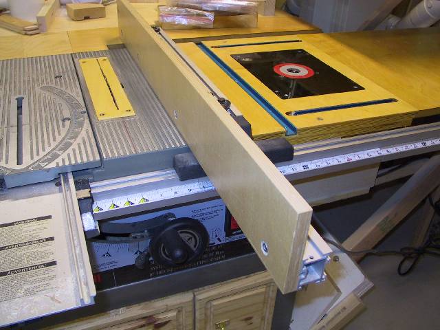

      There's lots of good ways to do it to suit your needs. Mine is a piece of baltic birch ply (~5" x 40"), with a stiffening rib along the length that I attached to the face of the fence. It hangs over the front of the table by ~12", and helps immensely in aligning rip cuts. (This photo shows my older version, based on the long rip/miter accessory, but you get the idea.)
Name:	Long-n-Tall Fence.JPG
      I've since added a little infeed support to the bottom of the leading end of the fence.

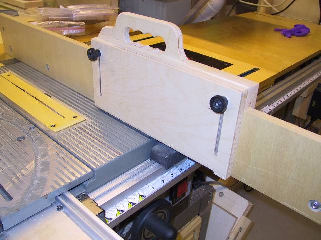

      An added benefit to the "tall" aspect of the fence is that you can easily make lots of useful jigs like this push shoe. It's adjustable height, and by riding the fence it keeps my hand safely away from the blade.
Name:	Push Shoe1.JPG

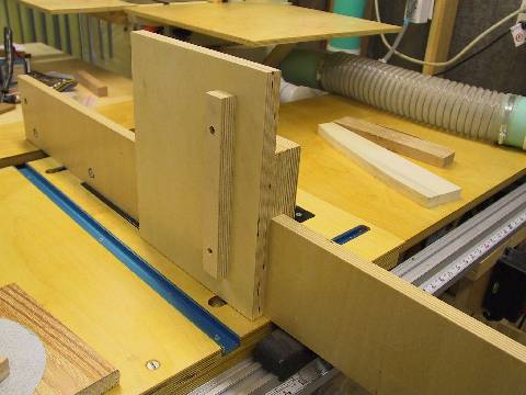

      Here's a tenoning jig that was quick and easy to slap together, while performing quite well.
