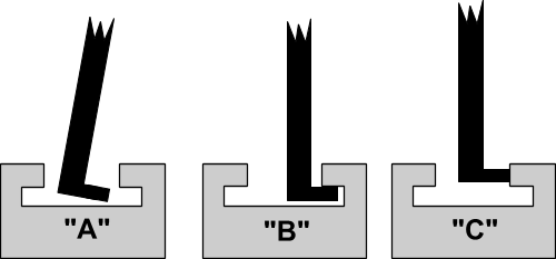

      Are you sure that the rear clamp is correctly situated in the rear slot, as this is quite easy to get wrong. The diagram below may help explain what I'm getting at.
      The fence needs to be inserted into the rear slot first (often with the front lifted up at quite an angle in order to get the clamper under the extrusion) - "A" below. If this is not properly seated, the clamp will try to shut on the side of the extrusion ("C" below) instead of the correct location ("B" below). This would produce the sort of groaning noise you refer to.
      The adjustment of the rear clamp, once correctly located, is largely a matter of trial and error, plus personal preference. I like my rear clamp to engage with the handle almost horizontal, so that it's fully locked with the handle at about 4 o'clock, when viewed from the left side.
