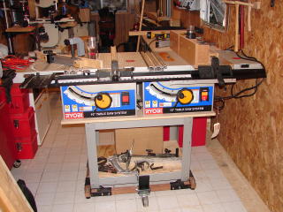

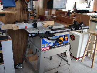

                  Doug,

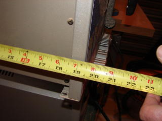

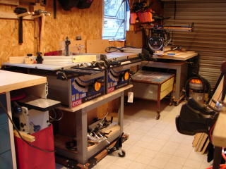

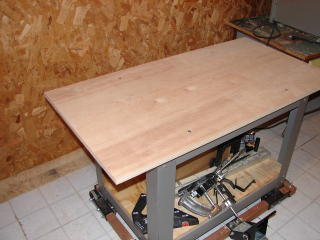

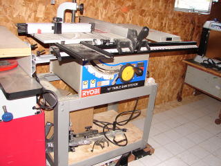

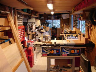

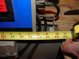

                  There are quite a few older threads on frankensaws, and recently in the past few months I was able to purchase another forum member's BT3100 to compliment mine - Thank You Vinht! I too am space challenged ( my shop is 7'6" wide by 30' long, an old job site trailer) so I joined the 2 saws with half rails for now (I think I'm in the 62"-66" total width range). I haven't finalized my cabinet plans for this frankensaw setup but for now I mounted the 2 saws on a 3/4" plywood base mounted on top of one BT3000 rectangular stand with a Delta mobile base. This is my temporary setup which works fine for now, plus I need the saw and the dado head (mounted in the left saw) to construct the new cabinet.
                  As far as usefullness, this setup works for me as I do a fair amount of sheetgood construction and I can roll the assembly 90 degrees off the wall and do long rips.
                  I've included several photos of the construction of my "temporary" base. Hope this helps.
                  The first photo is my 3100 and the second photo is teh 3100 I purchaced from Vinht. The rest are assembly and final orientation related.

                          Russell - awesome! Basically exactly what I was thinking about.; thanks for the pics. I'm a bit surprised that you can get both saw bodies on a small-ish platform on the stand. This may indeed make for a very nice temporary setup. I was originally thinking I'd have to get my mobile base up and running before I could experiment, but I may give your arrangement a shot.

                            Doug,
                            Thanks for the kind words. A couple of things about my temporary setup. My dado head is actually installed on the right hand BT. The dimensions on the 3/4" plywood under both saws is something like 21" or 22" deep by 42" wide. I was able to get the space between the two saws down to about 3". That's the closest I could get them with overly stressing the electrical connection from the left hand saw. Ultimately, I am going to finish building a mobile base from an old Wood magazine article (that Pappy has been using for several of his tools, most recently his lathe). On the mobile base I am still going to use the old 3000 stand with cabinet inserts on the sides and underneath. If I ever get a chance to finish it I will definitley post some pictures. I am trying to pressure myself into completing this so I can then finally adjust all my bench and tool platform heights to the same dimension off the floor. We'll see.
