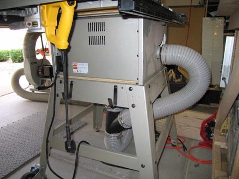

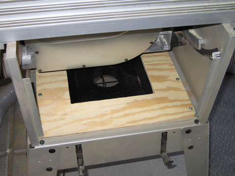

    I got tired of always having to vacuum underneath the saw, so I finally got around to putting in a dust pan bottom and hoses, similar to others that have been posted here. Even with all of the holes and slots in the cabinet, the airflow holds a piece of paper against the ventilation slots on the right side by the motor, so I think it will work OK. The airflow produced by the blade out the back port along with the DC suction should ensure that the dust will be cleared out that way. I'm planning to cover the rear dust port slot with the articulated cover designed by Jim Frye: http://www.bt3central.com/articles/files/dustport.pdf

    Heh, exactly what I did some time back and never got around to posting pictures. You're right, it does a fine job - all the dust is now on the top of the tool instead of under it.
    Looks like you used the same HF dust collection accessory kit bits (hose + big square plate + Y-tee).
          Yeah, I mail-ordered the kit over a year ago, before I found out that there is a HF store about 7 miles away.
          Someday, I'll get ambitious and install 6" pipe across the ceiling with drops to my tools, just like the big boys do. Until then, I'll keep stumbling over the hoses on the floor.
          One frustrating thing I've noticed is that the push-on "female" hose fittings that are available (I got some at Woodcraft) don't really fit the "Y" and other "male" fitting ends for switching hoses around. They will jam on OK, but also fall apart pretty easily. I think the push fittings are for blast gates and others that have the slightly-tapered male fittings, while you're supposed to clamp the hose to the untapered male hose fitting ends. I should just break down and order some Fazlok fittings: http://woodworker.com/cgi-bin/FULLPR...ARTNUM=121-595
