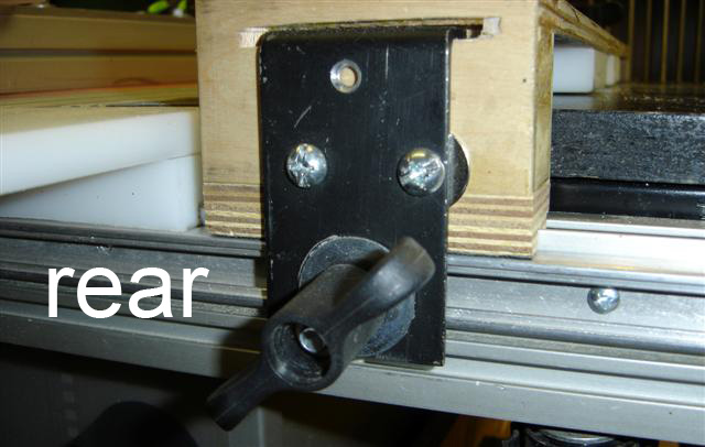

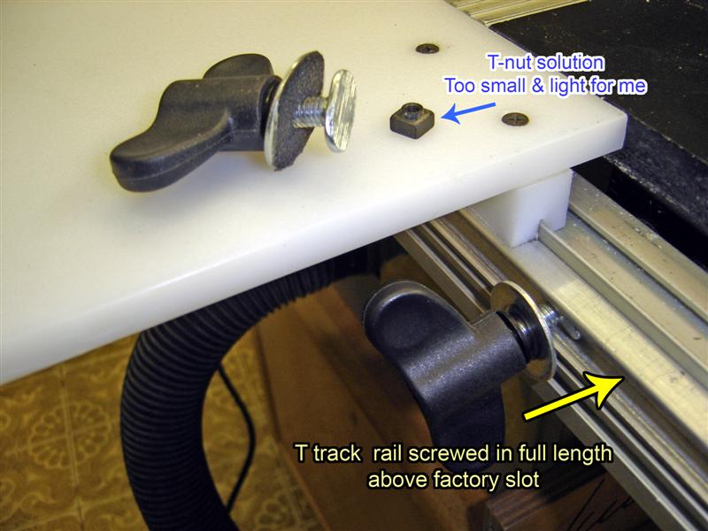

                    I made a feather board holder from plywood that attatches in the front with tnut and rear with toilet bolt. It sets approx. 3/4" above the table so that the feather boards I made could be attatched above the ply. or below. A t-track was added on the rear rail of the saw in order to secure the rear.
                    Actually I use it alot more with the router table side. Refer to pix.

                            T-nuts are a bts best friend. Ive got an assortment of them all, the only ones I cant recommend are the small square head ones for the back of the rear rail. The best solution I came to was adding a t-track above the slot back there, then using regular 5/16 toilet bolts you can really crank everything down tight.
