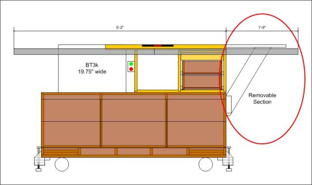

            I think I get what you're saying, because that's an issue that I was trying to address with my newly made mobile base. I have the extended rails, but I plan to cut the extensions in half so I can remove that portion when I want to swing the mobile base around.
            The last ~20" hang over the end of the mobile base, and are supported by a removeable cantilevered support (bolted onto the side of the base with 2 bolts.
Name:	BT3 Mobile Base w-RemTab.jpg
            I thought of using the hinges, but I think I'll just make that portion of the table/rails removeable.

                I did the same thing on my mobile base. I ended up cutting 1/3 off my rails and putting the short ends on the left. Jeffs hinges do a great job of taking the "wiggle" play out of the quation that I got using standard metal hinges. Make sure that what ever you do for a top that it holds the rails tightly and squarely. Good luck!
