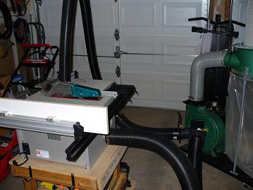

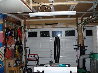

                        I also move my tools around but when it comes time to use the table saw I always place it in a certain place due to my garage floor being uneven. This way I don't have to check it for being level in different spots every time. I then have a length of cord attached between the rails of my garage door and droop the 2 1/2" hose coming from my DC over it hanging down to the top of the Shark guard. Here's a picture.
                        Boy that one picture sure didn't turn out too good but you can get the idea I think.

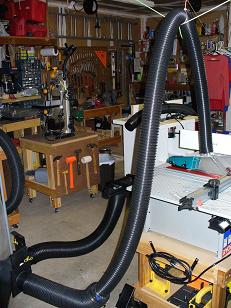

                          Ok let me try that again. I know I can do it.
                          • wreckwriter
                            • 449
                            • South Florida
                            Heh, no, not too good!
                            Yea, I get your point though and I suspect I'll also end up with a "sweet spot". Nothing in my house is either level nor plumb :/
                            I haven't made my first real cut yet, still learning everything I can so I can do it right and keep all my parts!
                            http://www.wreckwriter.com/
                            • wreckwriter
                              • 449
                              • South Florida
                              Yea, much better. You've got a nice shop! A real DC system and everything. Hopefully someday my garage will look something like that. I'd be ashamed to post a pic now....Thanks for the tip.
