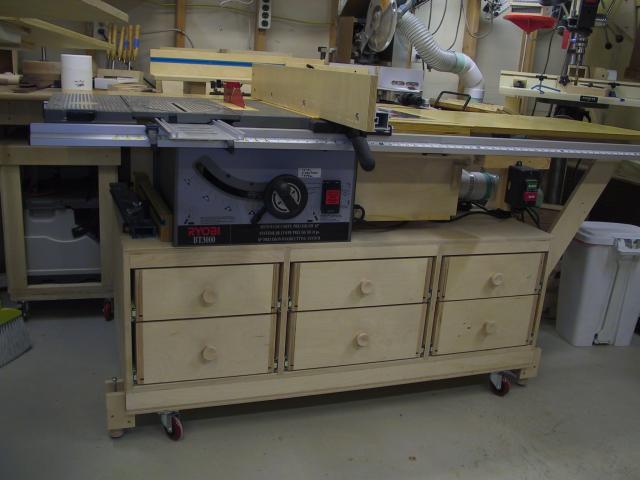

    BT3 Mobile Base: Phase 1 Complete
    ...well, as complete as it's gonna get, anyway. Someday (i.e. never) I'll add drawer fronts and trim.
    I made the base 4.5' wide, and plan to make the last ~1.5' - 2' of the table detachable; hence, the cantilevered support on the right. This will make the base even more mobile in my shop.
    Phase 2, BTW, will be a new compartment for the router (including a new table), with drawers to the right which will extend to the end of the base on the right.

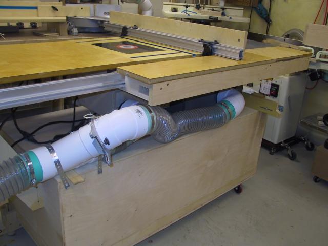

    Another big improvement is getting the saw and router table DC mounted solidly. There's enough play in the hose to the saw so I can change bevel angle. Blast gates for the saw (visible) and router (not visible), are easy enough to reach over the saw table.

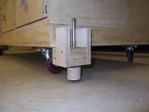

    I had installed double locking swivel casters in front, but in the end I wanted this to be rock solid. So, I made and installed these levelers (one on each side) which really does the trick:

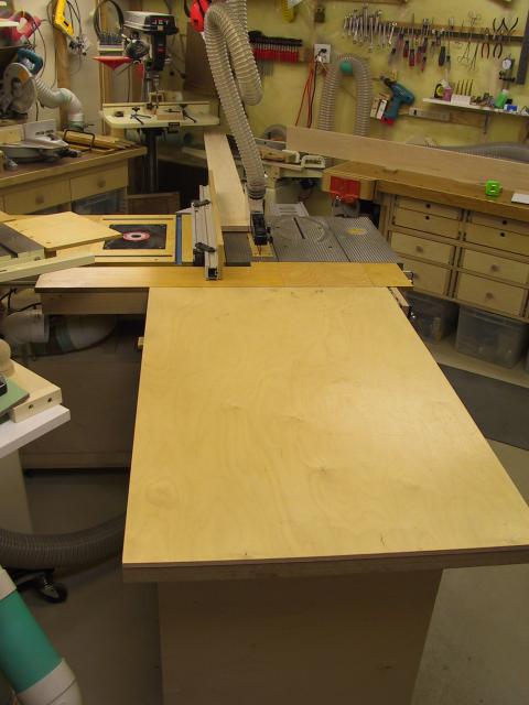

    Now that I'm much more mobile, it's easy to move the saw and outfeed table around to make room for this 8' long rip in my 13' x 15' shop.
Name:	Long Rip Outfeed.jpg

      For the levelers, I assume you just sandwitched a t-nut between the plywood and use a rachet to lower the foot, once in place?
        Actually, the t-nut is on the bottom of the 3-layer piece. I made it 3 layers with a fairly snug hole so there would be little side-to-side slop. Still, it's smooth enough operation that I can raise and lower by hand, until the foot contacts the floor. Then I give it a couple half-turns with a wrench to make it solid.

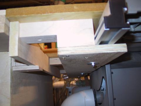

                              Here's some detail on what I call, for lack of better term, the "intermediate outfeed table". The main purpose was to be a buffer for the SMT travel, so it wouldn't bump into my outfeed workbench/cabinet. Like you say, it also blocks off some space for DC. Sitting on the Outfeed Table proper is a little filler piece for the Intermediate Table where the SMT goes.
Name:	Intermediate Outfeed.jpg
Name:	Int Outfeed Underside.jpg
                              I've re-worked the attachment slightly since these photos, but it's still essentially the same.

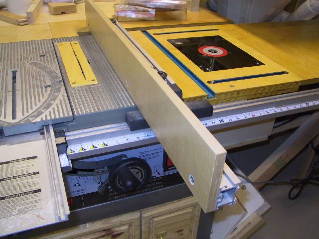

                              Here's my Long-n-Tall fence. I bought the Ryobi accessory long rip extrusion, only because it was on clearance. But I really like having a long (3.5 ft) fence.
Name:	Long-n-Tall Fence.JPG
