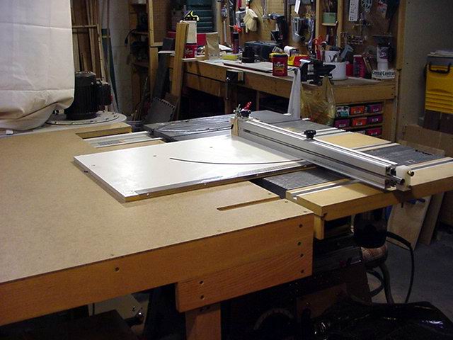

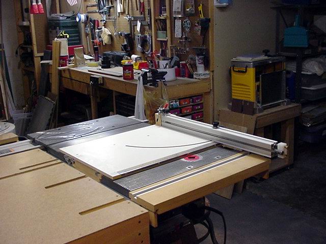

            Dubby
            The more I use it the better i like it, a couple of pictures for those who have not seen one.
            Vaughn \"Brad\" Bradley
            \"Eat an elephant one bite at a time\"
